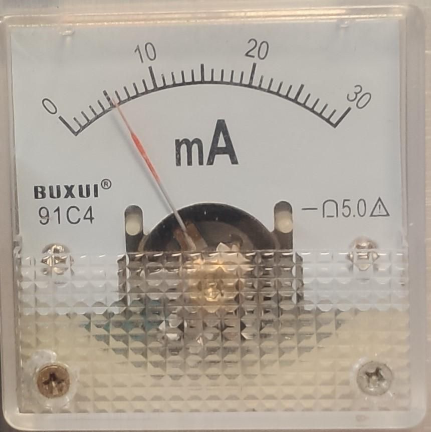

While working with my Co2-Laser for a while now, I wanted to knew all the parameters about the Laser Tube. However the most common setup to measure the Current of the Lasertube is to use an analog Amperemeter like this one:
It wasn't my favorite at all, so I have put it in my switch cabinet, but because the knowlegde of the current is so important I have startet to design my own Digital Amperemeter.

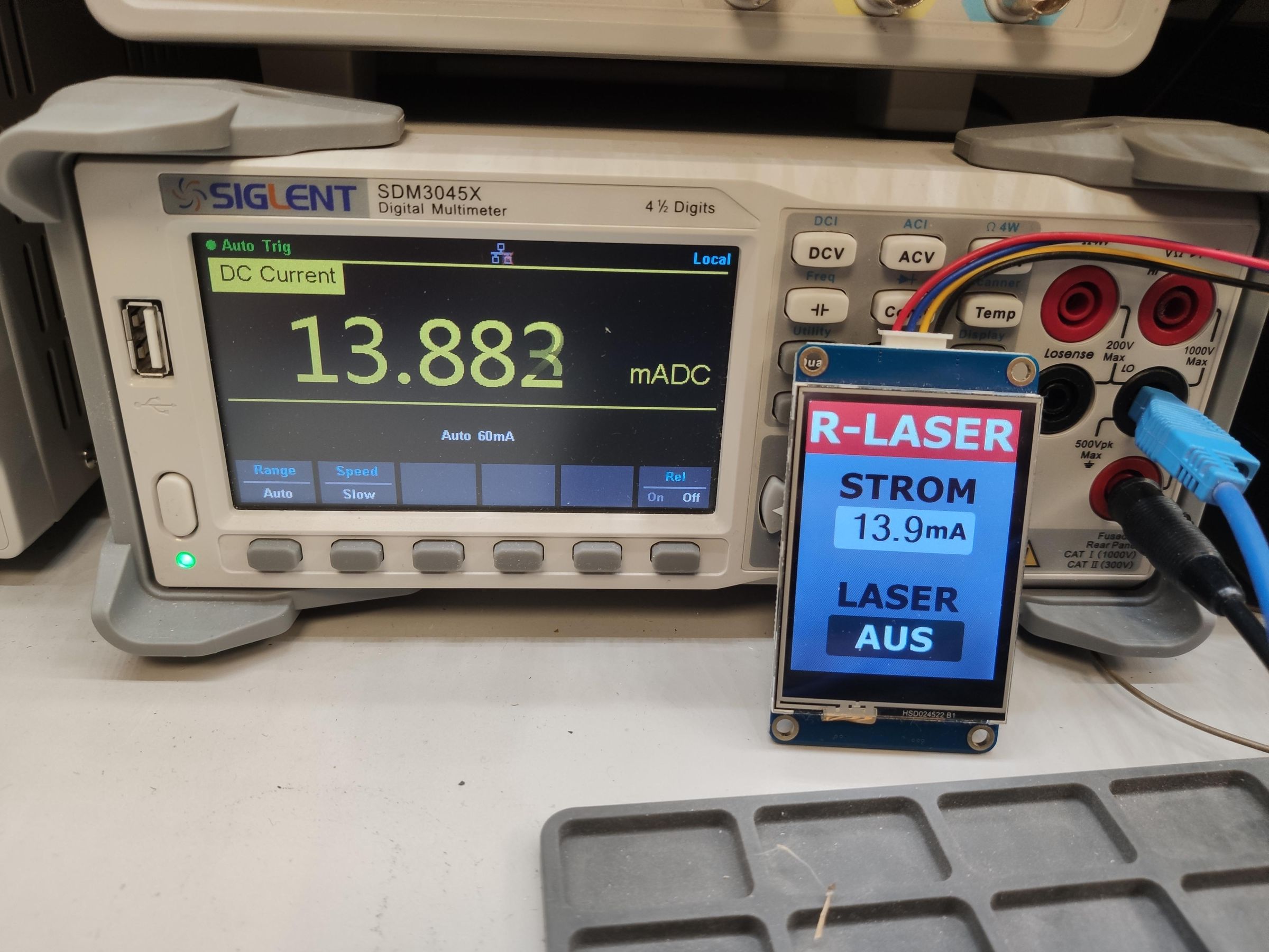

Video of the Amperemeter in Action at 9 mA RMS:

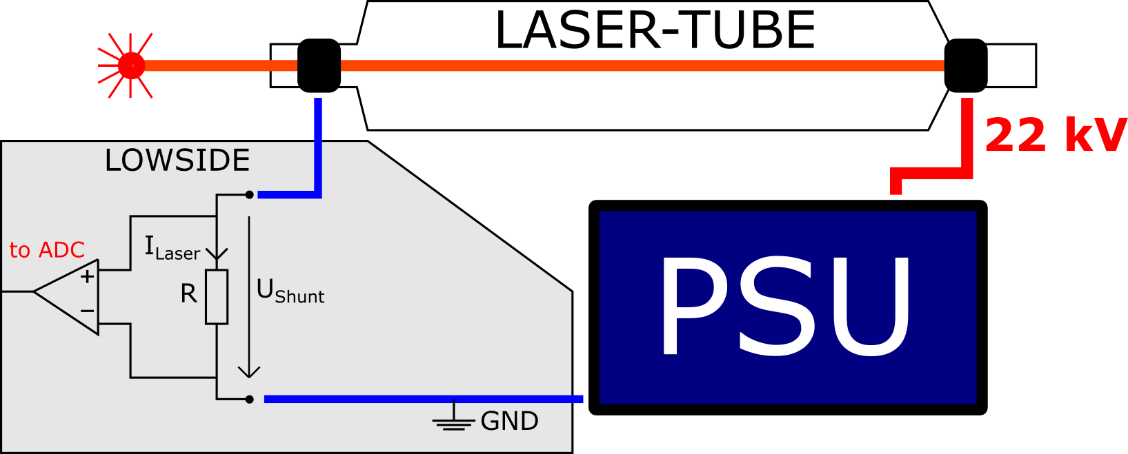

The equivilant circuit:
The common China-Laser setup is to use an High-Voltage Powersupply, which will force the Laser to start the beam. Then the current of the Laser-Tube flows through the Lowside back to the PSU.
To Measure the Current I have put a Shunt-Resistor in the Low-Side Path, so I could calculate the current with Ohm's Law:
But sadly the Shunt Voltage isn't really constant so I will need to calculate the Root-Mean-Square (RMS) Value to calculate the effective Current.

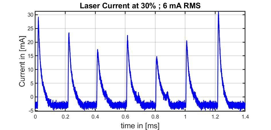

The Real Current:
I have measured the real Current of the Tube at 30% with my Oscilloscope and as you can see the Waveform looks like an expontial fall at 5 kHz:
The Idea is to sample the Voltage at discrete Timesteps way faster than 5 kHz with a Microcontroller and calculate the RMS-Value from these discrete values.
For this purpose I have used a STM32F103. To sample the Values, I have configurated the 12bit-ADC in DMA Mode. I will sample 1000 Values at once, then I will calculate the Root-Mean-Square of all these Values.
And as you can see I will come pretty close to the RMS-Value of the Current:

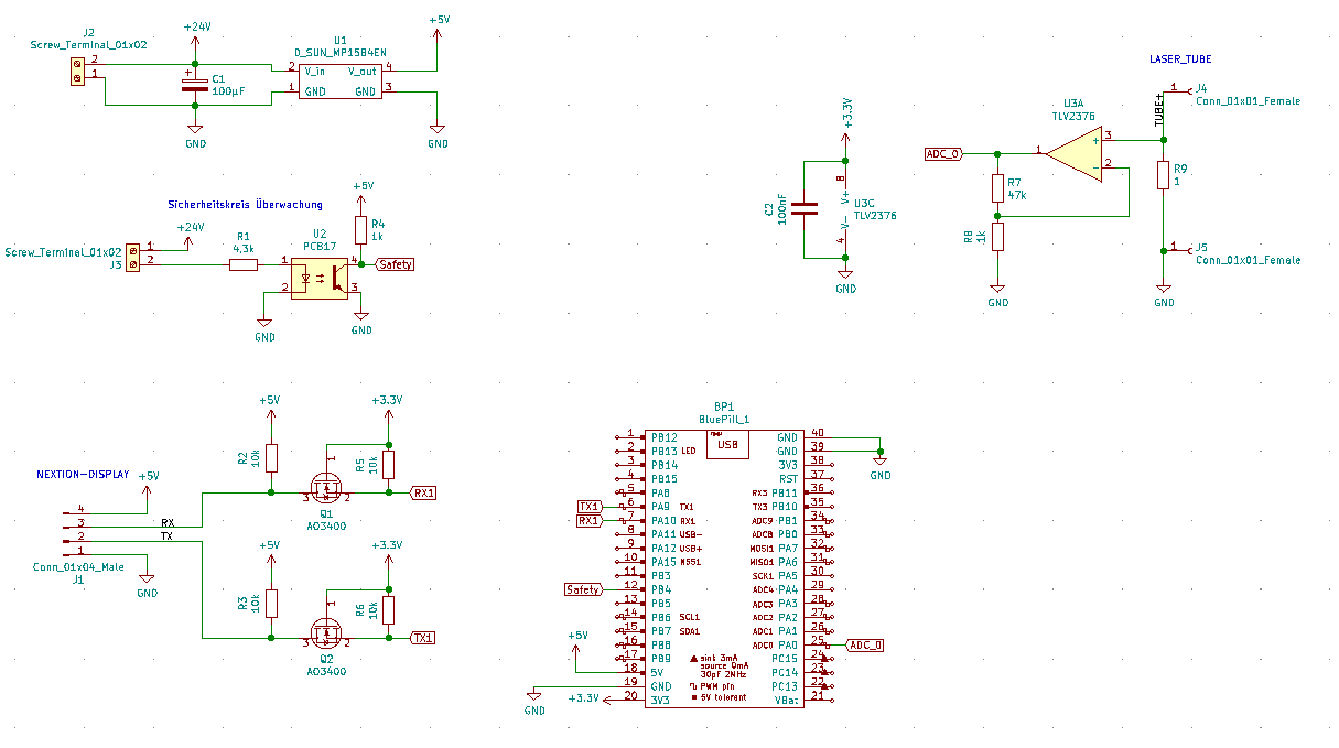

Step 2: The Circuit
The Circuit of the Amperemeter is relative simple. The main cuircuit is just an Non-inverting Amplifier + some level shifters. I have used a TLV2376 Op-Amp from Texas Instruments.

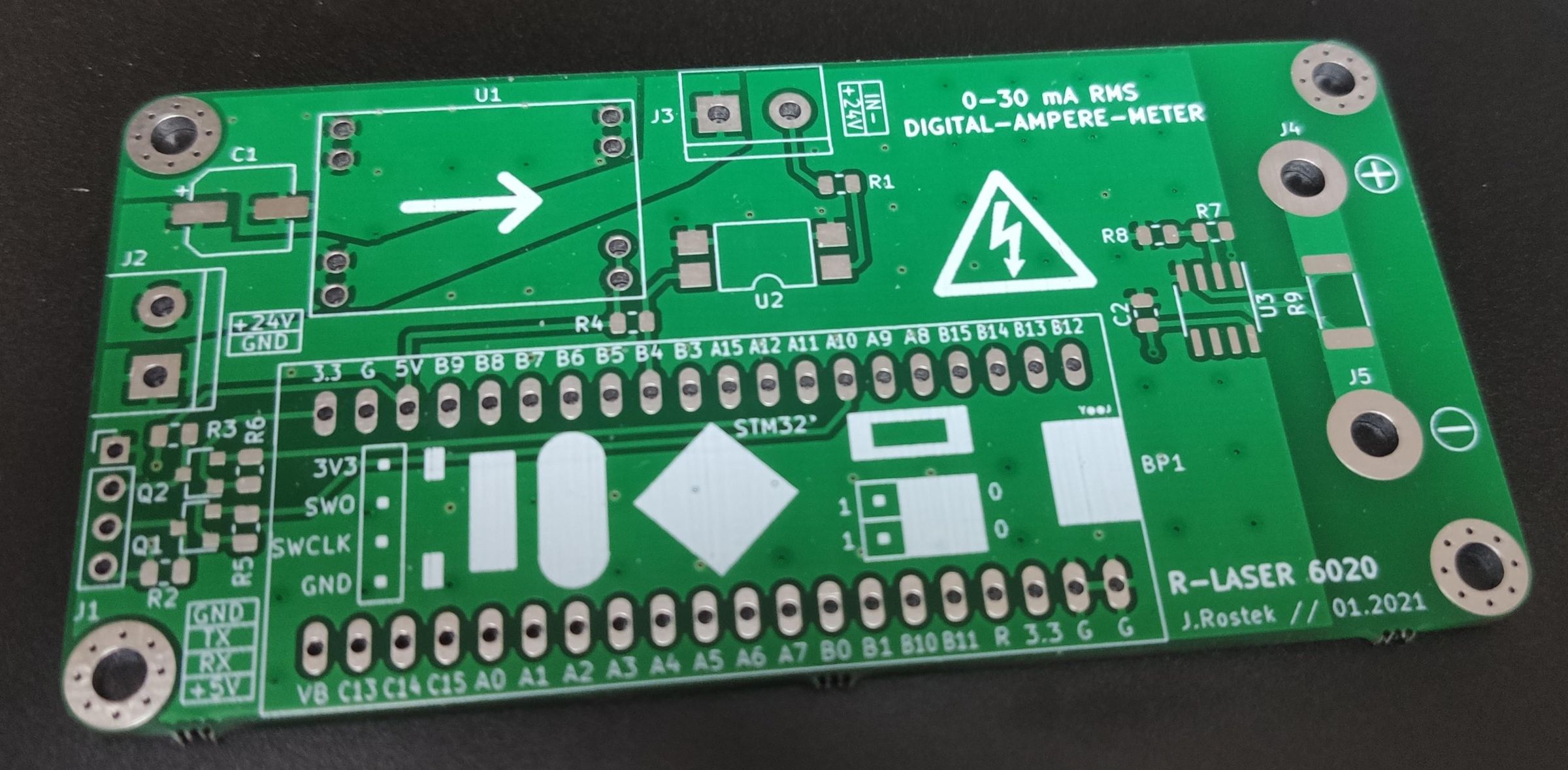

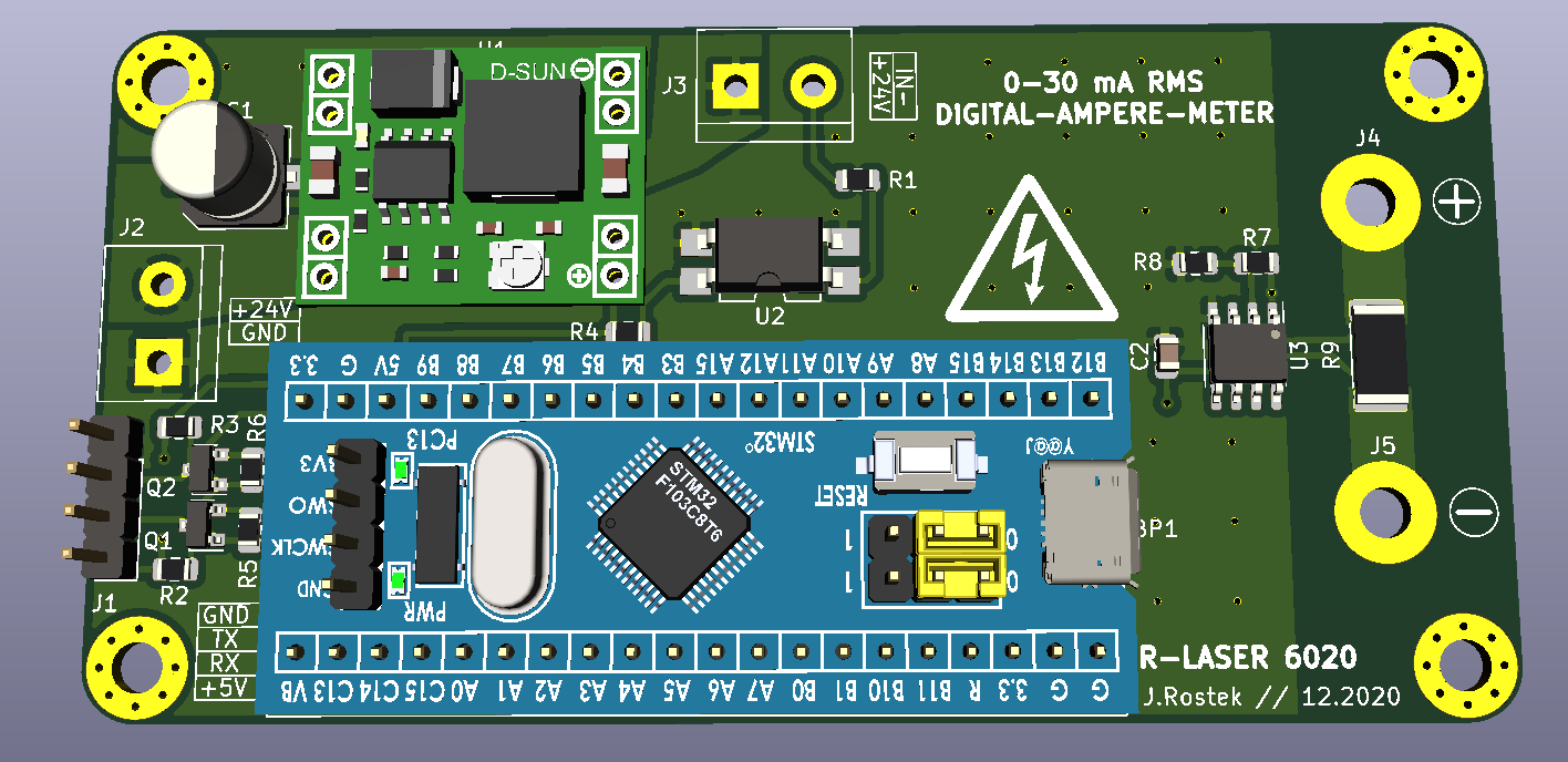

The PCB
For this project I designed my own PCB. Because I could only bought 10 PCBs at once, you can buy the remaining PCBs for a cheap price at Vulcaman.de
Source Files
Here you will finde the Schematic and the Board-Files for the PCB. The PCB is designed in KiCad
You can download all the Files below
