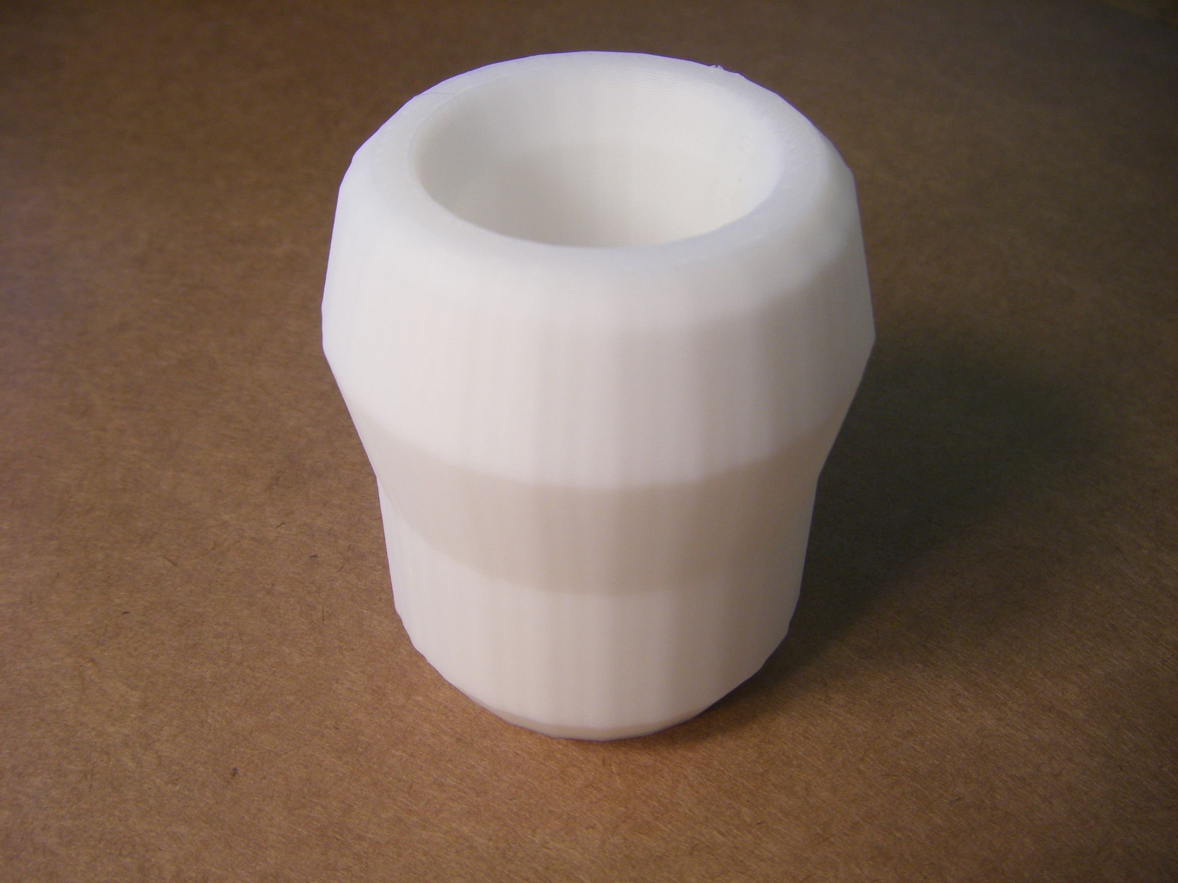

Step 4: Preparation of the Digital Files
The final sculpture and core were exported from Zbrush and imported into Rhino 3D. This was done to make it easier for me to scale the models and add registration points that would be necessary to make sure everything was where it needed to be during the molding and casting process. Both the sculpture and core shared the same origin when imported, which made it easy to check that everything was properly aligned. Identical registration columns were set the same distance apart so both pieces would fit in the appropriate place in the final mold. After the registration was added, the core and the sculpture were exported in the proper file format to be sent to the 3D printer.

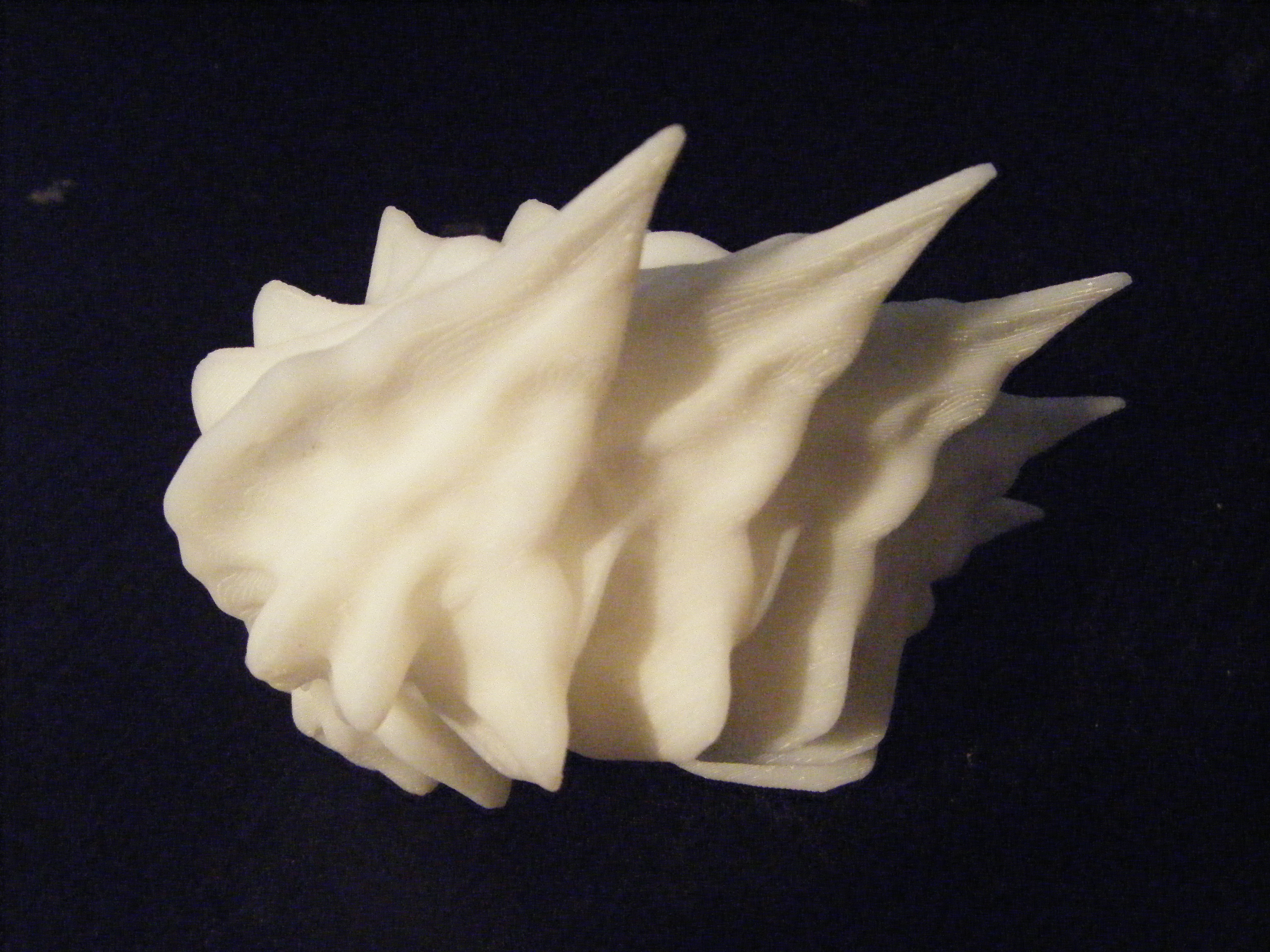

Step 5: Rapid Prototyping
The finished files were sent to a Dimension SST 1200 ABS printer. It prints by layering heated ABS plastic and a support material in .010" layers. The support material dissolves away when placed in a special bath after the model has finished printing. The ABS models are durable and can be molded several times as opposed to a clay model that is usually destroyed in the molding process. This reduces material waste and can allow for several molds to be made if many castings will be necessary. If further detail is desired, you could sculpt on the surface with clay or if you would like a permanent solution, Apoxie Sculpt from Aves is great. It is a non-flammable, non-hazardous synthetic clay that sets a 2-3 hours without shrinkage. In this case, I like the fingerprint-like texture the printer left behind, so I decided to leave the model how it was. Before committing to the full size sculpture, I printed a quarter scale version of each to make sure they were what I wanted. You can see how the core and sculpture register into a test mold box.
