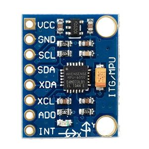

GY-521 Accelerometer
This module is one of the best IMU (Inertia Measurement Unit) sensors which is compatible with Arduino. IMU sensors like the GY-521 are used in self-balancing robots, UAVs, smartphones, etc. The GY-521 sensor contains a MEMS accelerometer and a MEMSgyro in a single chip. It is very accurate, as it contains a 16-bit ADC for each channel. Furthermore, it captures the x, y, and z channel at the same time. The sensor uses the I2C-bus to interface with the Arduino. The GY-521 is not expensive, especially given the fact that it combines both an accelerometer and a gyro.

IMU sensors usually consist of two or more parts. Listing them by priority, they are an accelerometer, gyroscope, magnetometer, andaltimeter. The GY-521 is a 6 DOF(Degrees of Freedom) or a six-axis sensor, which means that it gives six values as output. Three values from the accelerometer and three from the gyroscope. TheGY-521 is a sensor based on MEMS (Micro Electro Mechanical Systems) technology. Both the accelerometer and the gyroscope is embedded inside a single chip. This chip uses I2C Bus system for communication.

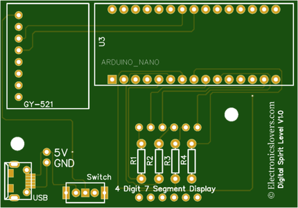

Step 4: PCB Design for the Digital Spirit Module |
We Have Designed a PCB Model for our digital spirit module by using one of the Best online PCB simulation Tool is known as EasyEDA – Online PCB design & circuit simulator EasyEDA is the platform where you can test your skills, where you can learn new skills and where you can even modify your skills. It is a place which provides you great web based EDA tools for electronics engineers, educators, students, makers, and enthusiasts. You all are welcome to use these tools for free and to create your own online web-based Printed Circuit Boards. There’s no need to install any software. Just open EasyEDA in any HTML5 capable, standards-compliant web browser.
- PCB Gerber View – JLCPCB Online Gerber Viewer
Step 5: The PCBs Arrived for Our Project
We ordered Online PCBs for our product Module from JLCPCB. They provided us the PCB’s for this project, which we used to assemble all the components to it. JLCPCB is the largest PCB prototype enterprise in China and a high-tech manufacturer specializing in quick PCB prototype production, They have the best offer for PCB’s: 10 pieces for only 2$. If you want to prototype your own PCB, go ahead to jlcpcb.com and upload your Gerber file to get high-quality PCB’s.
