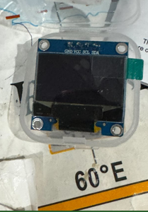

Step 1: Wiring and Downloading Ssd1306 Libaries

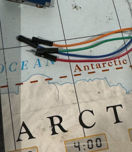

We will first wire the pico and lcd. Connect pin 36 or 3v3 out of the pico to vcc of the lcd, next connect pin 38 of or gnd of the pico to the ground of the lcd now connect gp0 to the sda of the lcd now connect gp1 to the scl of the lcd now the wiring should be done note however if the wiring is improper or is not connected properly the program will give you an eio time out. Now we have to download libaries to do this go to tools, then click manage packages now go to the search and search ssd1306 you should see micropython-ssd1306 click on it and press install.

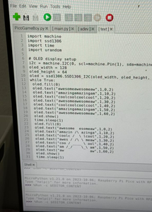

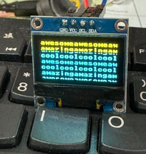

Now to finish off we are going to add the text so for the first line add the text like this:
 oled.fill(0)
 oled.text("awesomeawesomeaw",1,0,2)
 oled.text("amazingamazingam",1,10,2)
 oled.text("coolcoolcoolcool",1,20,2)
 oled.text("awesomeawesomeaw",1,30,2)
 oled.text("coolcoolcoolcool",1,40,2)
 oled.text("amazingamazingam",1,50,2)
 oled.text("awesomeawesomeaw",1,60,2)
 oled.show()
 time.sleep(1)
This is going to display the word pattern on the oled in this case awesome, amazing and cool now we finish off my adding more texts to loop or repeat over and over

Ok now save it as main.py in pico's folder now run it you should see the pattern followed by a iembeded in the pattern followed by a dot followed by the s.
