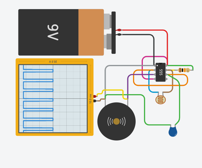

Update: Guys, I have also designed this another theremin using LDR & 555
![Theremin: an Electronic Odyssey [on 555 Timer IC ] *(Tinkercad)](https://content.instructables.com/FLJ/4GK0/JNULFJFT/FLJ4GK0JNULFJFT.png?auto=webp&crop=1%3A1&frame=1&width=130)
