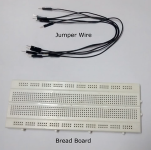

Step 2: Components Required
1. Arduino UNO
2. LM35
3. Bread Board
4. Jumper Wires

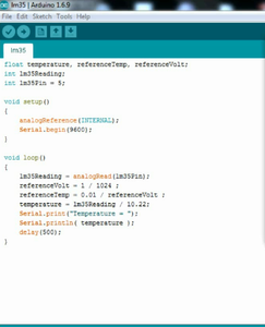

Step 4: Sketch Explanation
Declarations
This is where the variables are declared which will store the values during execution
float temperature, referenceTemp, referenceVolt;
int lm35Reading;
int lm35Pin = 5;
Setup - Setting the arduino pins
void setup()
analogReference(INTERNAL);
Serial.begin(9600);
the statement analogReference(INTERNAL); is used toConfigures the reference voltage used for analog input (i.e. the value used as the top of the input range).
& the statement Serial.begin(9600); is for setting the baud rate
Loop
This is the place where all the things happen. This is main core of the sketch or program.
void loop()
lm35Reading = analogRead(lm35Pin);
referenceVolt = 1 / 1024 ;
referenceTemp = 0.01 / referenceVolt ;
temperature = lm35Reading / referenceTemp ;
Serial.print("Temperature = ");
Serial.println( temperature );
delay(500);
  • lm35Reading = analogRead(lm35Pin); - This statement will the read the value from the LM35 which is an analog value.
  • referenceVolt = 1 / 1024 ; - This will be our reference voltage
  • referenceTemp = 0.01 / referenceVolt ; - Now if your wondering from where did i get the value 0.01. The answer is simple if you refer the datasheet it says "Linear a 10.0 mV/'C scale factor" which means for every 10m volt or 0.01 volt change there is a 1 degree change
  • temperature = lm35Reading / referenceTemp ; - This statement calculates the temperature
  • Serial.print("Temperature = "); & Serial.println( temperature ); - This statement is to print the values in the serial monitor
  • delay(500); - For every 500 milli second the loop will execute
Important Note : I have used 1 volt has my reference in my sketch, so please kindly change it to 1.1 volt in the statement & comment the line analogReference(INTERNAL); ( i.e referenceVolt = 1 / 1024 ; into referenceVolt = 1.1 / 1024 ; ).
Using 1 volt will limit temperature range to 0 to 100'C approx and if you are using 1.1 volt you will get a range of approx 0 to 115'C.
If you refer the LM35 datasheet the temperature range is -55 to +150'C so we are not utilizing the full potential of LM35, i.e is the one drawback.
If your wondering why i used 1 volt instead of 1.1 volt, using 1 volt as my top range i got the near exact temperature and with 1.1volt i got nearly 1.5'c difference. This may be because a faulty LM35
If you are trying, I strongly Recommend you to use 1.1 volt as the reference
