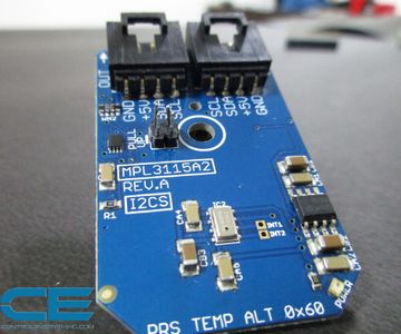

3. Altimeter, Pressure and Temperature Sensor, MPL3115A2.
The MPL3115A2 is a MEMS pressure sensor with an I²C interface to give Pressure, Altitude, and Temperature data. This sensor uses the I²2 protocol for communicating. We purchased this sensor from Dcube Store.

Connection of the Sensor and Raspberry Pi
Take the sensor and connect the I²C cable with it. Make sure that I²C Output ALWAYS connects to the I²C Input. The same to be followed by the Raspberry Pi with the I²C shield mounted over it.
We have the I²C Shield and the I²C connecting cables on our side as a very big advantage as we are left only with the plug and play option. No more pins and wiring issue and hence, confusion is gone. What a relief as just imagine yourself in the web of wires and getting into that. As simple as this!
Note : The brown wire should always follow the Ground (GND) connection between the output of one device and the input of another device.
