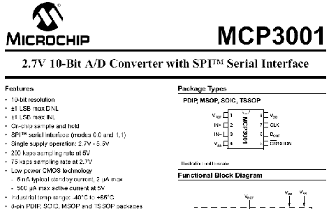

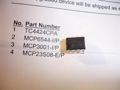

And a MCP3001 analog to digital converter from Microchip at http://microchip.com/ , another converter can be used if it uses the same method to transmit the measurement result, and you may need to modify the code
datasheet:
http://ww1.microchip.com/downloads/en/devicedoc/21293b.pdf

This particular A/D converter, MCP3001, uses a SPI serial interface, after reading it's database, it all becomes very clear.

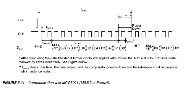

Clock, (aka "CLK", or "CK") is used to synchronize data transmission, it lets two different components send bits at the same speed, a single bit is sent in one clock cycle.
a clock cycle is putting the clock pin high (aka "on", "positive", or "+") then low (aka "off", "negative", or "-") , basically generating a square wave
Data, (aka "DAT", "DT", or "D out") is what outputs the reading values, it will output either a 1 or a 0 in one clock cycle, and your microcontroller stores that bit
Chip Select, (aka "CS", or "SS", SS means slave select, same thing though) is useful when you have multiple serial interfaced devices connected to just one microcontroller, only the chip that is "selected" will work, on this converter, putting the CS pin to high means not selected, while putting the CS pin low means you want to use that chip, and it begins to work
For A/D converters, sometimes the converter needs time to take a sample, for the MCP3001, you need to give it two clock cycles while it takes the sample, then the bits starts to stream in to your microcontroller, those are then stored in the memory of your microcontroller
The code will use the basic stamp's shift in command which makes this process easier, if you are using something else, you can manually make the clock high, read one bit, put the clock low, pause, and repeat until all 10 bits are read and stored
For more information, please read the MCP3001's datasheet
the images below are from the datasheet, READ IT

Connect the chip select pin on the converter to pin 0 on the basic stamp, clock to pin 1, data to pin 2
"V ref" is the reference voltage input, connect that to the 5v voltage regulator's output
"V in +" pin is the reading input, and it should be connected to some sort of probe, or the 3v regulator for testing purposes
"V in +" pin is the reading input, and it should be connected to some sort of probe, or the 3v regulator's output
"V in -" pin is also a reading input, and it should be connected to some sort of probe, or the ground (which means negative)
Vss is connected to the ground, and Vdd is connected to the 5v regulator output
The battery on board your basic stamp's development board should be enough to power the entire thing, so connect the positive battery terminal to the input of both regulators, and the negative terminal to all the grounds on the regulators and the Vss pin on the converter
