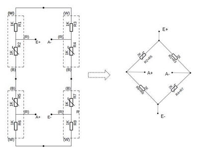

On the Web you can find many scales designs based on load cells with explanation of how strain gauges convert weight into a change of electrical resistance and instructions on how to build a digital scale.
Personally I found very useful this tutorial by Indrek Luuk (thanks Indrek!), with indication of the files for 3D printing of the supports and the software library to be used.
Although the article is very clear, for a better understanding in the figure above I highlighted the circuit diagram of the cell connections and the equivalent Weathstone bridge. This is also useful for checking the connections with a ohmmeter after the completion of the wiring. For example:
between terminals E+ and E- and between A+ and A- : R=2k
between A+ and E+ / A- and E- / A+ and E- / A- and E+: R = 1.5k

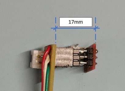

From the 40x20mm prototyping board I made a small "L" shaped board. The TTP223 sensor is mounted via 3-pin male and female pin headers, which also have the function of a 17mm spacer.
I replaced the red SMD LED of the TTP223 with a 3mm blue LED oriented downwards, in order to illuminate the floor and make the activation of the scale more visible even from above.
On the opposite side I glued the 2-way JST connector for the battery and soldered it to the pads in "SMD style".
Finally, I soldered directly on the pins of the 3-pin header the 10 cm flat cable headed with a DuPont female connector.
