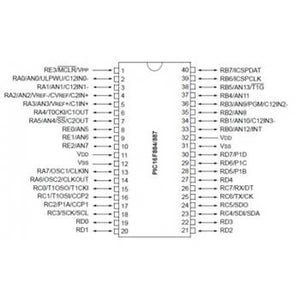

1. PIC 16F887 microcontroller 8-bit .

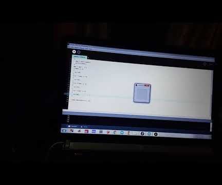

The circuit is being designed and verified at Proteus simulation software 7.7.
Step 3: Transmitter Circuit Diagram
This is transmitter circuit diagram that is designed on Proteus software 7.7.
It contains a keypad interfaced with microcontroller PIC 16F887 and LCD 16*2 which displayed the password that is typed.It checks the password which is stored in EEPROM memory of microcontroller and if it is correct then it passes the signal wireless onto the receiver.
This software can be used to simulate whether our circuit and code are running efficiently or not.

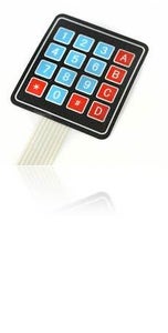

Keypads
Keypads have been used extensively in automotive applications as well as food industries.
Programmed Keypads can be used in automated attendance system at schools, offices etc, where you enter your ID, which is displayed and at the same time stored, to mark your presence.
Automatic door locks are usually accessed with a keypad control system in which a particular code is dialed on the keypad to open the door.

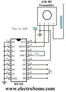

Step 8: Transmitter Circuit

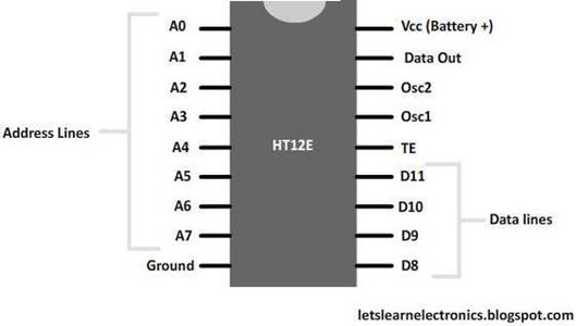

¨HT12E circuit along with rf transmitter
Encoder IC will convert the 4 bit parallel data given to pins D0 – D3 to serial data and will be available at DOUT. This output serial data is given to ASK RF Transmitter.
Address inputs A0 – A7 can be used to provide data security and can be connected to GND (Logic ZERO) or left open (Logic ONE).
Status of these Address pins should match with the status of address pins in the receiver for the transmission of the data. Data will be transmitted only when the Transmit Enable pin (TE) is LOW. 1.1MΩ resistor will provide the necessary external resistance for the operation of the internal oscillator of HT12E.

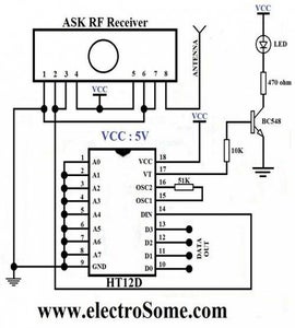

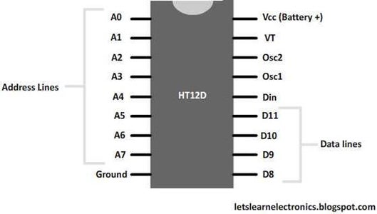

Step 9: Receiver Circuit
HT12D and RF Receiver
RF Receiver receives the data transmitted using ASK RF Transmitter. HT12D decoder will convert the received serial data to 4-bit parallel data D0 – D3.
¨The status of these address pins A0-A7 should match with the status of address pin in the HT12E at the transmitter for the transmission of data.
¨The LED connected to the above circuit glows when valid data transmission occurs from the transmitter to receiver. 51KΩ resistor will provide the necessary resistance required for the internal oscillator of the HT12D.
