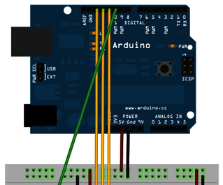

Digital potentiomter acts in a same way as analog one, except that instead of using fingers to adjust resistance you need to send signal from Arduino via SPI protocol.
In attached screenshots you can see:
- Pirice comparinson for other alterantives.
- How to use potentiomter with transistor in case if you want to use it for bigger load. For example to adgaste brightnes of LCD backlight.
- How to use it as volume control
- Arduino scetch
- Fritzing wiring file.
Pulldown resistors are 4.7KOhm (can be: 4K-10K.)
LED resistors: 470Ohm
