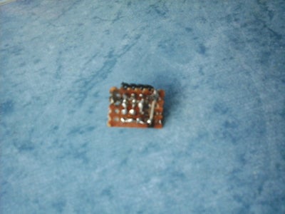

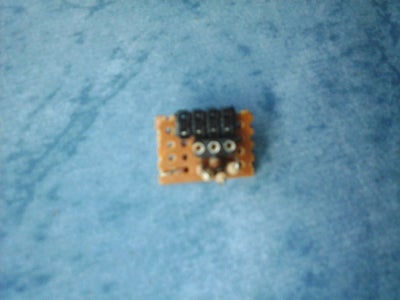

3 X 1K resistor
1 X male header (4 pin)
1 X female header (3 pin)
1 X Arduino UNO r3 board
I attched the eagle file and the schematic circuit. You can download it.

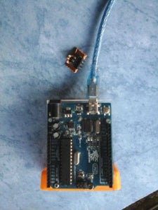

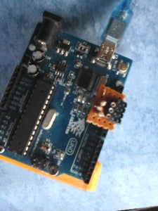

Step 2: Plug Tiny Circuit to Arduino
After you built the circuit, you can plug it to your Arduino UNO board using the male header. (Pins GND,13,12,11)

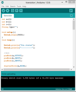

Step 3: Upload the Sketch.
Now connect your Arduino UNO board to your computer and open the Arduino IDE.

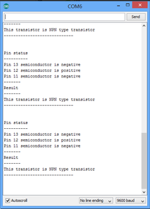

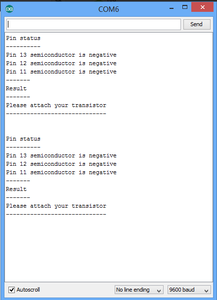

Then download the sketch file i attached and open the .ino file using the Arduino IDE and upload it to your Arduino board. After the uploading process complete open the serial monitor in your Arduino IDE. Now you can see the message like 'Please attach your transistor'.

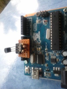

Step 4: Plug the Transistor You Need to Check.
Now plug the transistor you need to check to the female headers in the circuit.

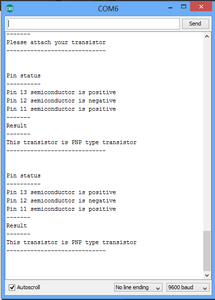

Step 5: Getting Result
After you plug the transistor to your circuit, the Arduino board pass the transistor information to the serial monitor. You can read the transistor information in serial monitor.
