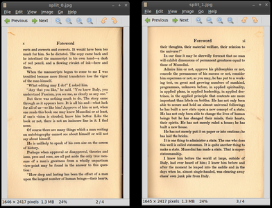

If in the last step you had to rotate the book to get a complete scan, the pages will appear sideways on your computer. Most computers now have the ability to rotate these images without opening any photo editing software. Use that to rotate each image to the correct orientation (i. e. left page is at left, right page is at right, words go left to right etc.)
Since we scanned both pages of the book at once, we will need to split them.

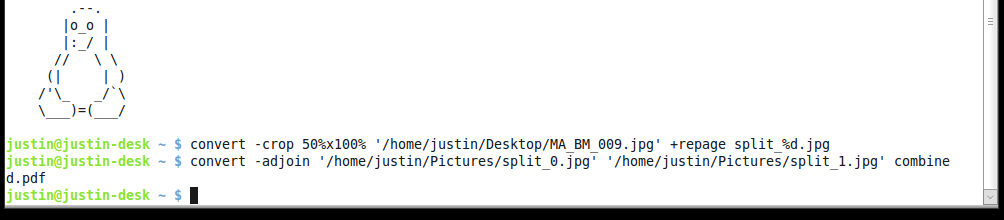

Open the Terminal in Linux. For this section, I am using a Linux Mint 9 operating system.
Type:
"50%x100% " will split the files down the center vertically. If you want to split it horizontally, type in "100%x50% ".
"filepath.jpg " is the file's path and name. You can drag the file (or multiple files) into the terminal to avoid typing out everything.
"outputname_%d.jpg " is the name you want for the output file. The "%d " at the end will add progressive numbering to the name. So when the file is processed, you will have two files named "outputname_0.jpg" and "outputname_1.jpg".
You can split multiple files by dragging and dropping them into the terminal. But they will be processed all at once, not one at a a time. Therefore, they will take a lot of processing power to accomplish this task. I recommend splitting 5 scanned pages at a time (i. e. splitting them into ten pages).

Once we have all the images split and in order, we are going to combine them all into one PDF file.
When you have to type the file's name, just drag and drop all the files. Remember, they all have to be in exact order for this to work right.
In the terminal type:
convert -adjoin 'filename_0.jpg' 'filename_1.jpg' outputname.pdf
"-adjoin " will combine the two files into two pages, not as one page.
"filename_0.jpg " is the name of the file you split. Remember, you can drag and drop multiple (preferably all) the files into the terminal for this step.
Now, you have to wait. You have to combine all the files at once into one PDF file. This will take a long time. I think it took a 300 page book about 20 minutes to process.
