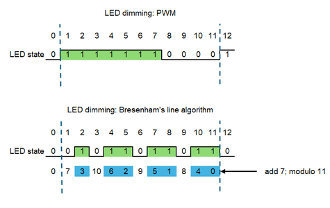

  1. Starting with the number 0 (for x-coordinate 0), we add 7 (slope numerator), divide that by 11 (slope denominator) and use the remainder as result (modulo operation).
  2. Then the same calculation is applied for x-coordinates 1, 2... to 11, each time using the previous result us input.
  3. This results in the following sequence: 0, 7, 3, 10, 6, 2, 9, 5, 1, 8, 4, 0 (see bottom of the picture).
  4. Each time a calculated number is smaller than the previous one, the y-coordinate increments by 1: we now have identified all pixels being part of the line approximation (the pixels colored green in the picture) !

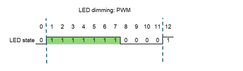

Step 3: LED Dimming With Bresenham's Line Algorithm
So, to draw an approximation for a line with slope 7/11 in a pixel grid, the y-coordinate needs to be incremented 7 times while the x-coordinate is incremented 11 times and y-coordinate increments should be distributed as evenly as possible.
But what's the link between a grid of pixels and a simple LED ?
Imagine an LED with 12 (not 11) brightness levels (0 = OFF, 11 = fully ON) and a desired brightness level 7. So, again, 7/11: within 11 consecutive ISR calls, the LED needs to be switched ON 7 times and switched OFF 4 times. And what's more, to prevent flicker, the 7 ON-pulses must be spread as evenly as possible over the 11 timer periods.
Ring a bell ? Yes, Bresenham's Line Algorithm ! Please refer to the figure for a comparison with PWM, always for brightness level 7/11. It's easy to see that, for a same timer frequency, the 'perceived' LED refresh time is smaller.

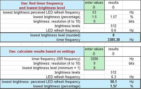

Excel tool
The 'extras' folder in the gitHub repository contains a useful Excel file for calculating:
  1. required settings (timer output frequency and lowest brightness level) in function of selected brightness resolution (bits), minimum lowest brightness (%) and minimum acceptable 'perceived' LED refresh frequency for lowest brightness
  2. lowest brightness (percentage) and 'perceived' LED refresh frequency frequency for lowest brightness in function of settings (timer output frequency, lowest brightness level and brightness resolution)
See the examples in the second figure above.

Bresenham's line algorithm
Applied when brightness level is not 0 (LED is currently not OFF).
At the start of a new LED refresh cycle ('if()' clause), the LED is always switched ON during the next timer T1 period.
Note that if maximum brightness is set, the step counter remains zero and the 'if()' clause is the only clause to be executed during ISR calls within the LED refresh period.
The 'else' clause implements Bresenham's algorithm as explained earlier.
if (stepCounter[index] == 0) {
ledStateBits |= ledBit;
stepCounter[index] = (ledBrightness[index] == brightnessLevelLedON[index]) ? 0 :
ledBrightness[index];
else {
uint16_t newStep = (stepCounter[index] + ledBrightness[index]) %
brightnessLevelLedON[index];
if ((newStep < stepCounter[index]) && (newStep != 0)) { ledStateBits |= ledBit; }
stepCounter[index] = newStep;
ledBit <<= 1;

Transition time
The time it takes to transition from full brightness to lowest brightness is the LED refresh period times the number of transitions:
transition time = (2^n - 1 - lowest brightness level) x LED refresh period
= (2^n - 1 - lowest brightness level) x (2^n - 1) / timer frequency
