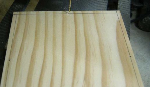

Step 2: Dial Face
In this step, drill the center of the dial-face after marking a corner-to-corner X in a square piece of wood 5 and 1/2 inches by 5 and 1/2 inches by 1/4 inch thick.

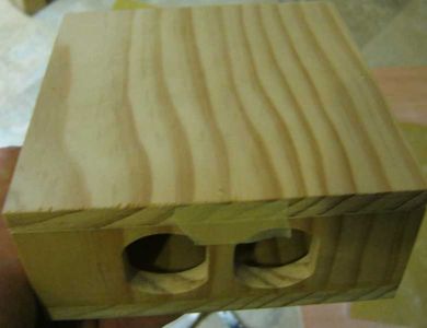

Step 4: Cutouts
In this step, take the 3 sides that have have been traced and remove the cut-out areas so that the switches and outlet fit. Finally, drill out the screw holes, making sure not to go through the wood completely. For the 4th side, include a hole for the fuse and input wire.

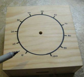

Step 9: Dial
In this step, create the dial circle:
- Secure the dimmer onto the dial-plate using a earthquake / mounting putty.
- Drill a popsicle stick so that that it can be used as a template form circle on the dial.
- Mark the limits of the dimmer.
- Use a protractor to split the usable circumference into 10 sections.
Step 10: Mark and Finish
In this step, mark and finish the pieces:
- Number the dial from.
- Label one of the switches with On and Off.
- Label the other switch with Dim and Full.

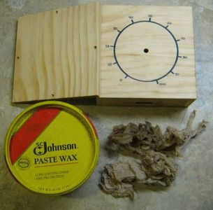

- Finish the wood with polyurethane.
- When dry, apply a coat of paste wax.

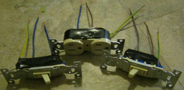

In this step, prepare the switches and outlet:
- Attach wires to switches and outlet.
- Insulate bare metal with electrical tape.
- Use contact cement to attach any washers that would be needed between switches and outlet or wood.

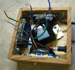

Step 12: Screw and Wire
In this step, screw everything into place. The use of a side screwdriver may be necessary. Use twist-on wire connectors to join the wiring.
