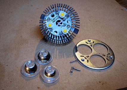

The first step is to take apart the bulb by removing the three Philips screws on the front faceplate. They are small and you will need them again, don't lose them! Carefully remove the metal faceplate and the three plastic lenses to expose the circuit board with the three LEDs

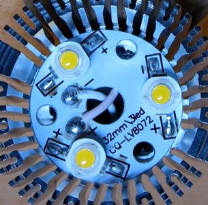

So just solder the bypass wires to the LED driver terminals marked "+" (pink wire) and "-" (white wire) in the image above. (Note your markings/colors may be different.) Since the wires are soldered to a heatsink you might need to increase the heat on your soldering iron. (You *are* using a temperature-controlled iron, right?)
Connect the + wire to the drain of the FET and the - wire to the source. (If that sounds wrong, remember the "source" of a N-channel FET should be more negative than the drain. Think of it as a "source" of electrons -- which are negative!)
