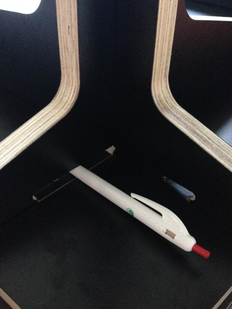

Step 10: Final Assembly
Once again place the upside down legs assembly onto the top assembly. Carefully adjust the pieces to fit using a pen to prop up each of the corners as you align them. Pull the pens out and with the help of a friend flip the newly completed table.
