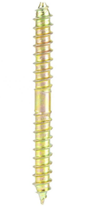

- Double-threaded screws
⚠️These screws must be at least 60x6mm (2.36x0.24in), but the bigger the screw, the more solid the result.

The diameter of the double-threaded screws you have will drive your choice of the drill bit's size. The drill bit's diameter must be smaller than the screw's diameter. For example, if you have a ø6mm screw diameter, use a ø5mm drill bit.
Note: Before to drill the actual holes, I strongly advise to test the holes' diameter and the double-threaded screw with spare bits of wood. That way you can see if the hole are too big.
When you are sure of the holes' diameter, drill the holes in the center of the eight crosses you drawn before. Be precise so that the holes are perfectly centered and parallel to the length of the legs and leg extensions.

The screws will be glued inside the leg extensions' holes on one threaded side. The other side will be screwed into the holes of the shorten legs when you want a dining table, and unscrewed when you want a coffee table.
You can refer to the 3D image with the 6 steps to help you with the following:
Carefully pour a few drops of glue into the first leg extension's holes (1). Take a screw and put glue on one of its threaded side (1). Engage the glued side into the glued hole and manually screw the tip until you can't do it anymore (2) (remember the hole's diameter is smaller than the screw's). Then take the leg extension with its screw and begin to screw the other side in one of a leg's hole (3, 4). Manually screw until the glued side is completely screwed inside the leg extension (5), and wait for the glue to dry.
When you unscrew the leg extension back, the screw must be firmly glued into it (6). You have one almost-full leg extension. Apply this step to the other three.
