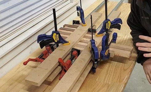

Step 3: Glue Up
Now put several lines through the laid out boards to mark their position. Now flip them on their side and spread out the wood glue. Be sure to use food safe wood glue and to spread evenly to the entire face of the boards. Now flip them back and clamp them up with good even pressure. Its a good idea to use cauls to keep your board as flat as possible. Let the board dry for 24 hours. Then remove the clamps and scrap off any excess dried glue.
