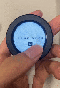

DINO GAME on ESP32S3 Round Display, that's it.

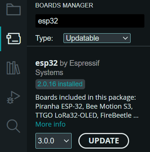

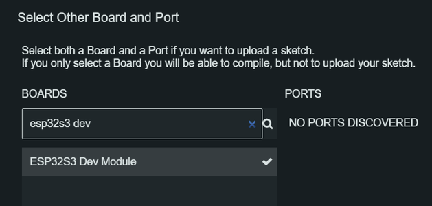

This LCD display has ESP32S3 on board, so you have to add esp32 in Board Manager. When you are uploading the code later, remember to choose ESP32S3 Dev Board as the target board.

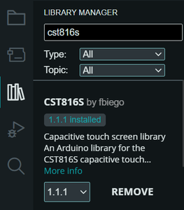

In this time, we are gonna use TFT_eSPI library by Bodmer (Giant thanks to him) which you can download from below. Remember to unzip the file in your Arduino library folder which in my case is located in C:\Users\...\Documents\Arduino\libraries. Using TFT_eSPI, you can drive other awesome displays. Also remember to install the CST816S library (see the image) for the touch function to work.
