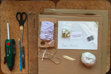

Suggested: A5-sized, 2-3mm thick PLASTIC Mirror (not Glass), Bosch Glue Pen, Cutting Mat and Scalpel.
Generic: String, Split Pins, Cocktail Sticks, Elastic Bands (optional), Ruler, Recycling stuff - plastic pots, etc.

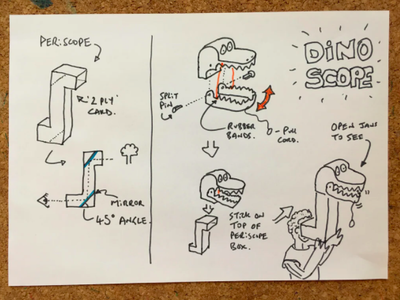

Step 1: Sketching & Thinking
You may not need to do this step, but whether you are a design student or a parent, I do recommend sketching out most ideas to think through how they will proceed.
Aside from it being a fun discussion with kids to discuss how the mirror will 'bend' light, it's still useful even for adults familiar with modelling to see how much they can accurately visualise and anticipate the steps...
...You may even notice in the sketch, I presume I'd use Elastic Bands to make the jaws open and close - only to realise that this is not actually necessary and actually impedes the play. Even LEGO-Alumni get it wrong! It's about the journey not 'being right' all the time ;o)
Also, if you look at many of my other Instructables - I do not use many measurements. This is not a lack of care to give you a PDF plan - but rather to illustrate how prototypers work at speed: The core 'technique' of speed-prototyping is to 'begin with the constraints'. So on this build, the 2x A6 sized mirror 'define the build', So I started with their dimensions as being the 'driving dimension' and everything else 'fits' around them.
(The alternative is to make everything else, and then have to carefully tailor the mirrors to fit - which will not only require more complex machinery, but also slow everything down).
From this, I build the scope, and from the 'Scope I built the Dinosaur head, from this I build handles, and so on. The core is the mirror(s) - the experience follows sequentially.

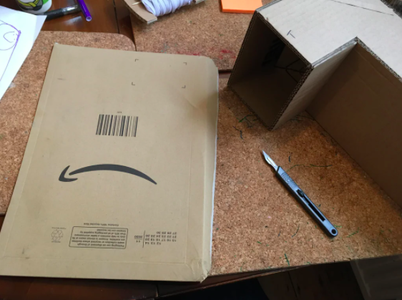

Step 15: Dinosaur Head - Investigation Prototype
"Investigation Prototype" - consider this the prototype for a prototype.
What I mean by this is that I wanted to get the proportions and mechanics/dynamics of the Head sorted out, but didn't want to risk using the thicker 2 ply cardboard, as I didn't have much left (hard to believe, but true).
So I used a cardboard packing 'envelope', from Amazon (not endorsed!), to sketch out an approximate shape of the head, and then checked it for fit to the Periscope I'd made already. The idea was to 'fit' around the top viewing port, and make this align with the jaws.
Teeth Tip: I realised that drew two sets of teeth, but actually it's better to cut from 1 line. Look at final pics and you'll see wha I mean. This means less cutting and a better end result.
I checked the jaw would open enough to 'see out of;, and also that the top jaws didn't get in the way. This soft of fine-adjustment is better done in a thin card, rather than 2 ply card!
I also realised that the upper port needed trimming to allow the jaws to open cleanly. See last photo. You may need to do similar.
