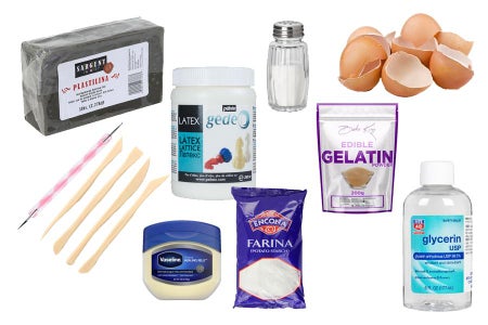

  • non hardening modelling clay
  • sculpting tools
  • oil or vaseline
  • liquid latex
  • starch
for the biomaterial:
  • eggshells
  • gelatin
  • water
  • salt
  • glycerin
