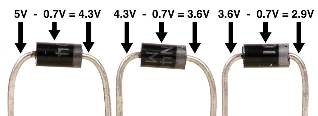

In order to overcome the depletion region, a little bit of voltage must be sacrificed. This is called the voltage drop. In a standard silicon diode this is typically 0.7V. In
other words, if you have a 5V signal and it passes through a diode with
a 0.7V drop, the voltage that comes out the other end will be 4.3V. It can fluctuate above or below this value depending on the type of diode.
If
you have three diodes in series, you will lose 0.7V through each diode
and the voltage at the far end of this chain will be 2.9V. This adds up to a
significant loss, and is the reason diodes should be used sparingly.

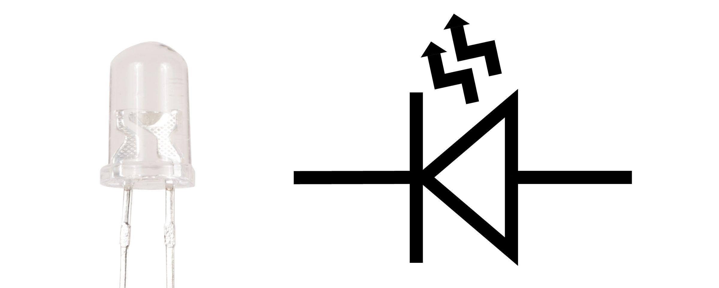

LED is an abbreviation for light emitting diode. Of all of the electronic components we are going to encounter in this course, the LED gets the most fanfare. It is the superstar of electronic components. You could say it shines brighter than the rest.
An LED is a diode that emits photons when it is forward biased and there is electricity flowing through it. The photons are simply light particles and what makes it glow.
If you look very carefully inside of an LED you will see a thin wire attached to the center of a small bowl. The wire bridges the anode and cathode to a semiconductor die located at the bottom of the reflective bowl. When current flows from the anode to the cathode, the semiconductor material emits photons, reflects off the bowl, and is further amplified by the plastic material of the cap.

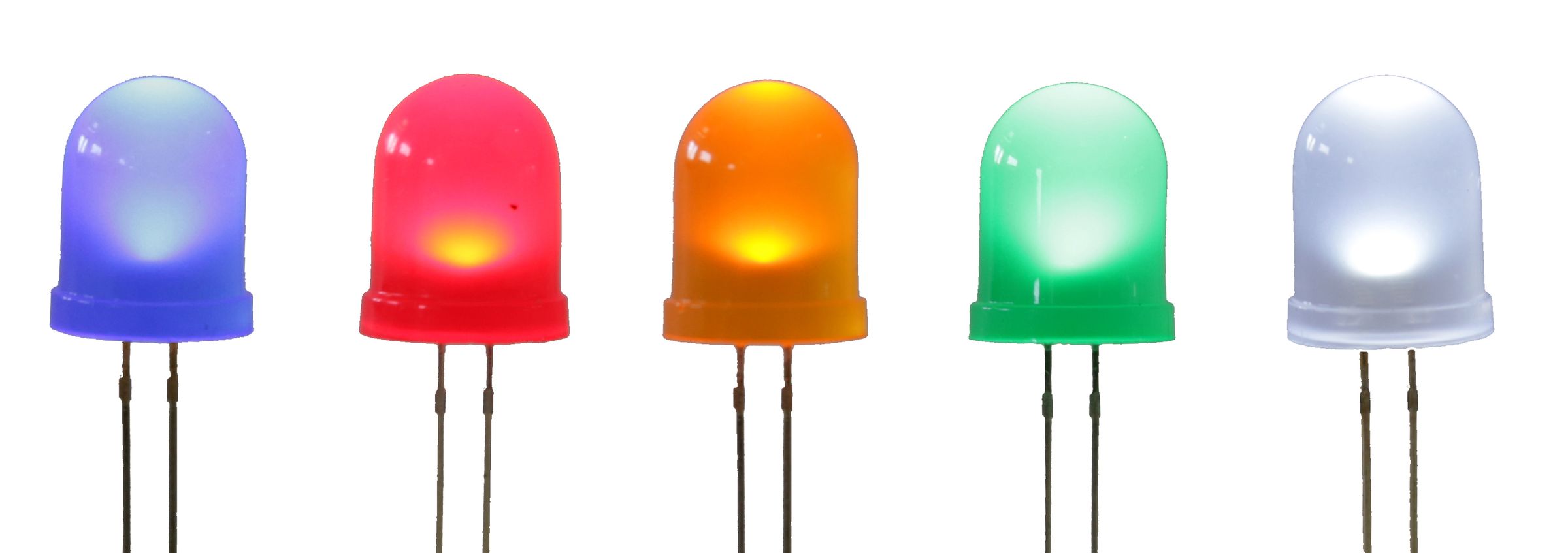

LEDs also come in many different colors. Often the plastic is tinted to indicate what color they are. However, clear LEDs are deceptive in that you might assume they glow white, but can actually glow a host of different colors.

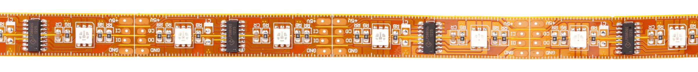

LEDs also come packaged in flexible strips. These strips are manufactured in white, solid colors, and multi-color, which can produce any color in the visible spectrum. Additionally, the multi-color strips either come in solid colors, or in programmable arrays where each LED can be a different color. Learning how to control programmable LED strips is beyond the scope of this class, but something you can do if you ever decide to learn how to use a microcontroller such as an Arduino.
