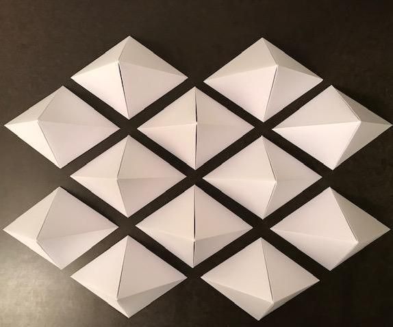

Taking one of our models, I have marked each of those small right triangles with a red dot on the top, and yellow on the bottom. When we unfold the model, a tally shows that sixteen of these triangular units combine to form its total surface area, two per each of the eight faces, half on the top pyramid, and half on the bottom. Those paired right triangles form the isosceles triangle of each face. Each has a base equal to 2 times the short leg, or 105mm, defining one of the four sides of the pyramids’ base (a). The lateral sides (e) are equal to the length of the hypotenuse, 90.94mm. The crease/joint line down the middle of the face gives us (s) the slant height, equal to the long leg of our right triangle, 74.25mm. Knowing a=105mm, we can find the perimeter (P), which is four times that, or 420mm. It is important for us to note that the perimeter is twice the width of an A4 sheet, for we will return to that relationship as we proceed.

A quick count of the total number of small right triangles per fold pattern per sheet, reveals a total of 32. Therefore, from the previous step, we know that only half are expressed on the surface, so the other half get swallowed into the internal structure of our model. This gives us the total surface area equal to one half the area of an A4 sheet.
By examining what is happening internally with the small right triangles that have been absorbed, we can find (h) height and (R) circumradius. Looking inside a half formed model (see photo) we can see that (h) height is equal to the short leg of our right triangle, 52.50, and that (R) circumradius is equal to the long leg, 74.25mm (one half of the diagonal through the square base). We now have only two unknown dimensions remaining, (r) inradius or apothem*, and the central angle (α). The central angle is simply 360 divided by the number of sides, 360/4=90⁰. To find the inradius (r) we can see that it divides the central angle in half creating a 45 45 90 isosceles triangle. Knowing one of its legs equals a/2, or 52.50, we see that the other leg, (r) must be the same.

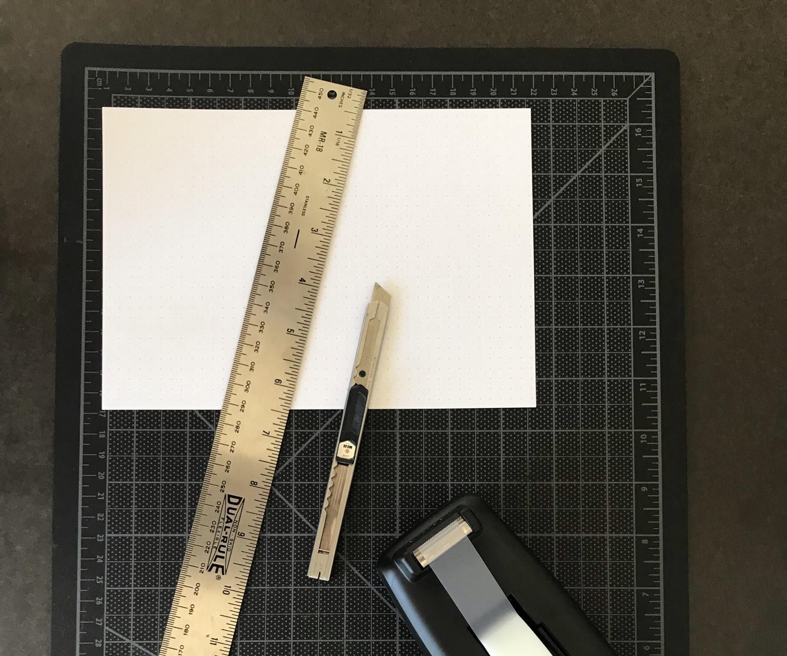

Step 7: Prepping the Sheet
I’ve jumped a little ahead of myself, with regard to how to find the length of our sheet, and why it is always equal to 4 times R, thus creased in four equal divisions of that length. Again, an examination of our unfolded model of the square based dipyramid, brings us to this conclusion. We can see that along the long length, the top faces (red dots) are all contained in the two quarters of the sheet on either side of center, and that the bottom (yellow) are in the outside quarters. We know that each rectangle of the total array (16) is equal to one half the total number of faces of a square based dipyramid. Therefore, it is logical to assume that the pentagon pattern will require an array of twenty, twice the number of its 10 faces. We already know that we are dividing the short length by 5, therefore the long length must get divided by 4. We will see that top and bottom faces are distributed similarly, as well.
So we proceed by calculating the overall length of sheet: (R)x4=285.84 which for our purposes we will call 286. We can subtract that from 297 (the A4 dimension) to determine we must trim 11mm off the long dimension of our standard sheet.
The sheet then gets folded in four equal parts along the long dimension, using our standard techniques shown in (Un)Folding the Mysteries.
Dividing in fifths along the short dimension requires measuring and marking, before creasing.
Scoring and creasing the diagonals is more or less straight forward, using our standard technique. However, it is important to take note that for the pentagon (and all odd sided bases), the diagonal does not go corner to corner through the center of the sheet.

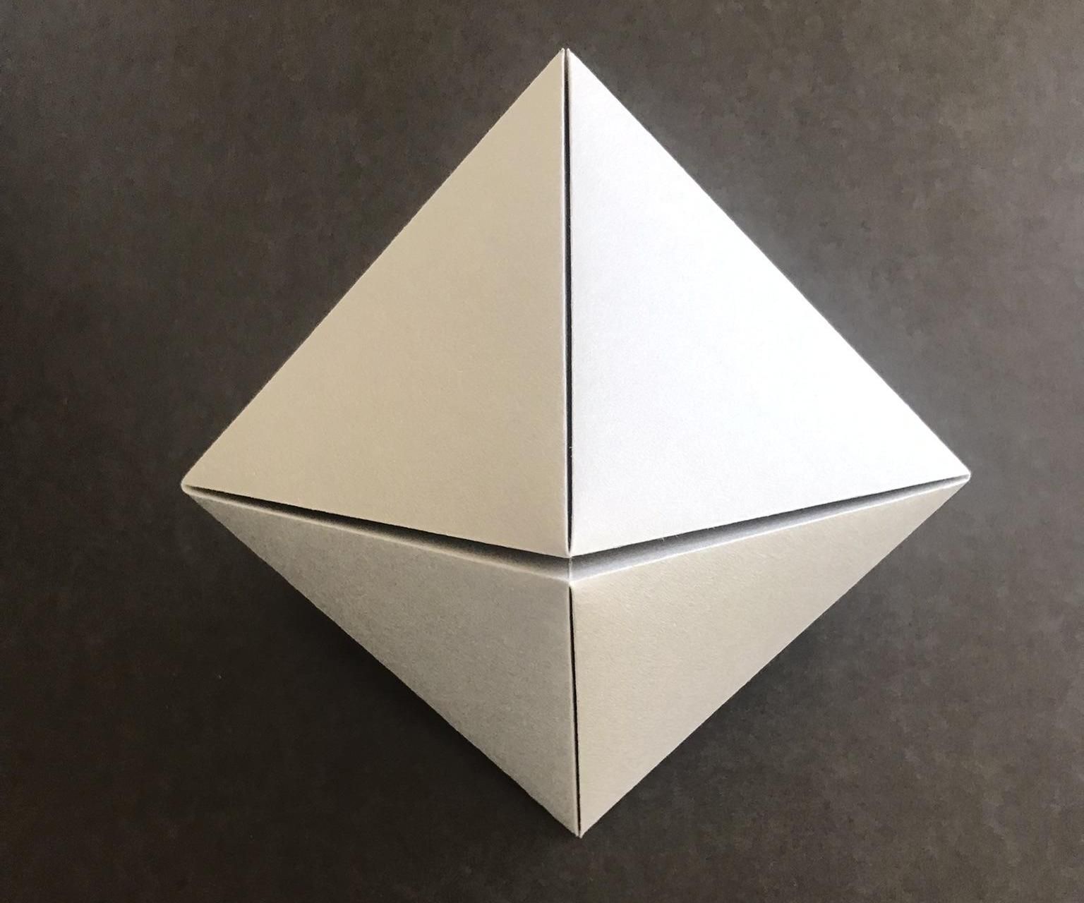

Step 8: Folding, Forming and Applying the Tape
Technique is the same, see (Un)Folding the Mysteries for details.
The Pentagonal Dipyramid is complete!
