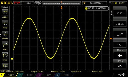

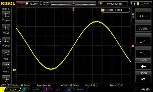

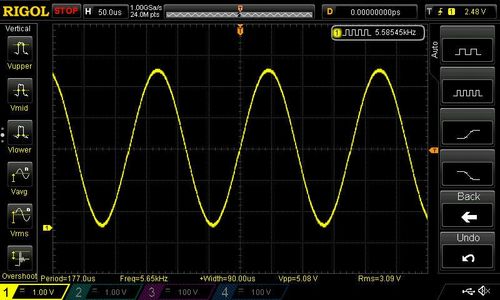

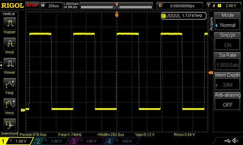

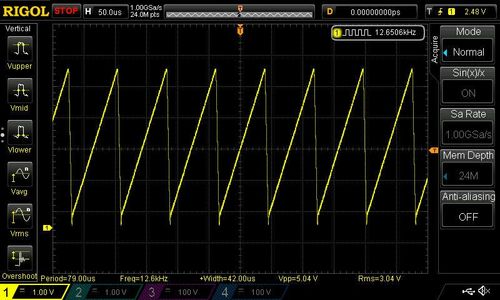

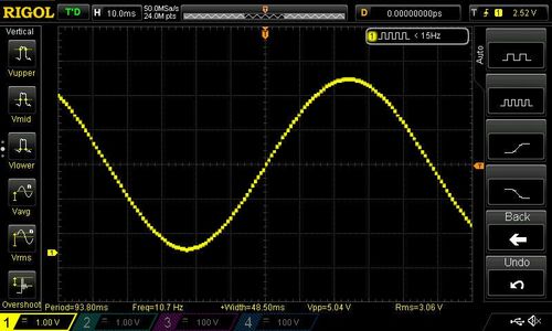

Arduino does not have Digital to Analog Converter - there is only PWM generator, but in order to generate smooth wave we need stable analog voltage. Common pattern to solve this problem is to take a few digital outputs and connect them together trough voltage divider - you can see that on schematics in the right bottom corner. We are using Arduino's digital output D0-D7 because they are all managed by single register (Port D). This means that we can change value of all 8 bits (D0-D7) with single assignment, for example: PODTD = B10000001 would set D0 and D7 to 1. This also means that mapping between byte value and analog output is linear. Attached images contain examples that I've measured using oscilloscope:

My first version has used Arduino API and I was getting about 150Hz for
sine with 120 steps - final optimization went up to 5,6KHz. I've used interrupts to handle input from buttons, direct registry access, removed all unnecessary method calls, reduced size of a variables - like from 16 to 8bits and finally exchanged floating points with integers.
