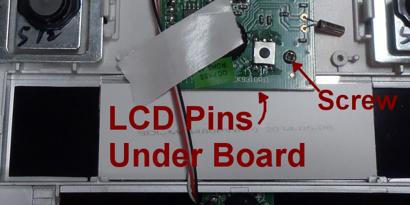

- Direct Connection - The pins on the LCD screen board are held against the pads of the driver board by force
In the kitchen scale, the LCD screen sits in the frame, and the circuit board is held against it with a few screws. In this way, the driving pads on the circuit board are making contact with the LCD pins.
There is no soldered or cable connection. If the circuit is not tightly secured to the case, the connection to the LCD is lost - as evidenced by missing segments or a very dim screen. This can make it difficult to attach any additional wires to the LCD. If even a single LCD pins isn't making good contact with the board, part or all of the LCD will not work correctly.
The following image isn't of this exact circuit board, but it does demonstrate the LCD pads on the board...

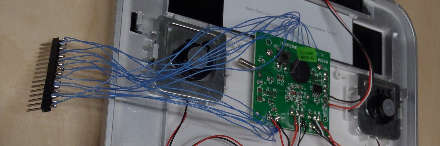

Step 4: Adding Wires to the LCD
This is where things get a little tricky. As mentioned in the previous step, the LCD pins still need to be making good contact with the driver board pads. You will have to use your best judgement to determine where you can solder wires to the board. I also recommend using incredibly thing wire; mine is 30 gauge.
- Locate the pads that connect to the LCD
- Solder wire leads to each pad (use thin wire, and small amounts of solder)
- Solder the other end of the wires to a header pin (keep them in order!)
- Reattach the board to the LCD.
- Apply power to ensure the LCD is still working.
- Optional - Coat the wire-header connection with hot glue for durability and insulation
At this point, we have no idea what wire does what, but that's OK. As long as you kept them in order (pin 1 on the lcd goes to pin 1 of the male headers, etc), it will be easy enough to figure out! At this point, we should probably talk a bit about how these LCD screens work.

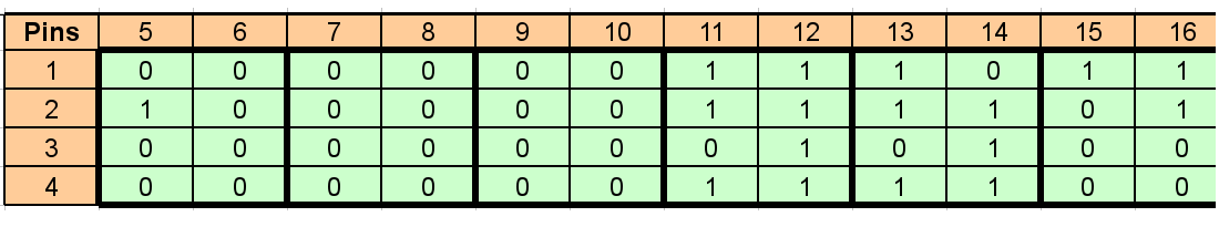

Record the Pin States for a known LCD screen
Using the logic analyzer (or O-Scope) we need to record the state of every single pin for all of the COM states. As long as the screen doesn't change, these patterns will repeat indefinitely; however, if a single segment changes, that particular control signal will change for one of the COM lines.I have highlighted the states of a few different pins for COM signals 1 and 3. Notice, a segment is ON when a pin is out of phase with the COM lines - when the COM is HI, the Pin is LO and vice-versa.
Create a matrix displaying all pin states for known LCD screens.
The hard part is finding the pattern - that is, which control lines are changing as a single segment of the LCD becomes active or inactive. It's a good idea to write all of these pin states down for various screens with subtle changes in which segments are active.
In this table, I put a 1 for any control line that is active (out of phase) with any of the COM signals, as seen in the previous pin state image. It is very important to take note of every active icon on the screen - some of them might be connected in seeming random ways.
The best way to find the patterns is to record the pin states after subtle changes. For example, the exact same time displayed with AM and then PM, or a digit displaying 0 and then 8. Remember, there are no chips or wire traces in the LCD, so the order of the control lines will likely correspond to the order of the segments on the actual screen.
Notice that the state of pins 11 and 12 seems very similar to 13 and 14. Given that the screen displays 0.0, could this mean that pins 11 and 12 drive digit 1, while pins 13 and 14 drive digit 0? This makes sense, given that there are six active segments used to form a 0, and the seventh active segment in pins 11 and 12 could be the decimal place! Additional readings with a similar display will help. For example, switching the mode from fl-oz to grams will change the display from 0.0 fl-oz to 0g. Suddenly, pins 11 and 12 all turn off, but pins 13 and 14 remain unchanged. I think we have found a pattern!
Fill in the map connecting control lines to LCD segments.
After enough readings have been taken, the complete pattern will be discovered. Since we are not directly driving the screen, the only way to test theoretical connections is to write down what you think the pins should be for a given display, and then make that display happen - in our case, this is done by switching to a certain mode and adding weight to the scale until a particular combination of digits is displayed.
In the case of the kitchen scale, the pins were arranged in a manner that actually made sense! The alphanumeric digits were grouped together, in the same order of their display. The only lines that were in a random order were the various unit icons, but that was to be expected. This table shows what control lines drive what segments for a given active COM signal.

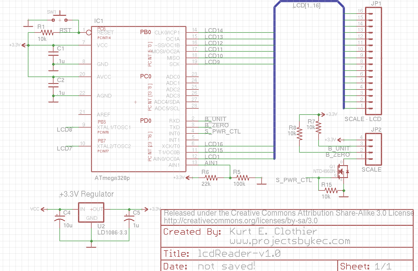

Step 8: LCD Reader Circuit Design
With a pattern (hopefully) found, we can create a circuit to read the LCD pins and do something useful with that data.
This circuit will be built around at ATmega328p microcontroller using all of the default fuse settings and no external clock source. Since the COM lines are analog inputs, we could read each one individually using the ADC, but this is unnecessary. The same effect can be achieved by reading just one COM line using the analog comparator, and then simulating the other three COM lines in software. You might also note that I do not have connections shown for pins 5 and 6. The reason is simple - I don't care about any of the data represented by those pins.
The analog comparator is really simple. We use R5 and R6 to create a bias voltage on AIN1. The output of this voltage divider is about 2.7V - similar to the 2.5V trigger threshold I used for the logic analyzer inputs! The COM1 line is fed into AIN0. Whenever the voltage on AIN0 rises higher than AIN1 or falls below it, the comparator will trigger. We will use this as an interrupt source to trigger the start of an LCD read cycle. This will also be used to keep our simulated COM lines in sync.
The last thing I want to point out are the connections to JP2 - I actually plan on taking full control of the digital scale. My circuit will be able to disable power to the scale and drive the mode buttons. I have opted to leave all of PORTC open. This frees the I2C pins for communication with other chips as well as a handful of analog inputs which might be utilized later. Your implementation will likely vary!
