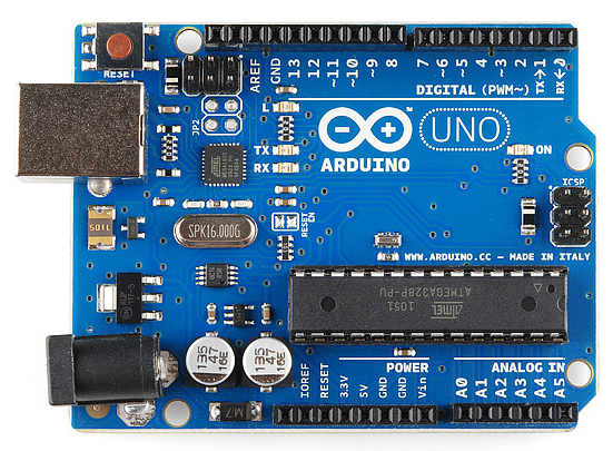

Step 3: Setting Up the Arduino
- Get a new box for the Arduino
- Drill 1 hole for the wires into it.
- Drill 1 hole for the USB cable into it.
- Make sure you can close the box and put the USB cable into the Arduino

Step 5: Wiring the Arduino
- Put all the wires into the Arduino & make sure you can still close
I put the push buttons to pin 2 & 3
The lights to 12 & 13
The grounds to ground
