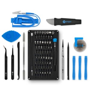

Make sure you have the proper tools (iFixit screwdriver FTW), alcohol, cleaning cloths, etc.—and lots of patience. Again: if you don’t know what you’re doing, don’t do it.

I used an iFixit toolkit, an Allen key set, isopropyl alcohol, and paper towels to clean.
