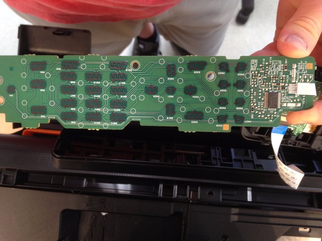

Step 3: Remove Display and Buttons
The display and buttons were pulled off of the printer. You get to see an interesting look at the capacitive buttons that are used to control the printer.

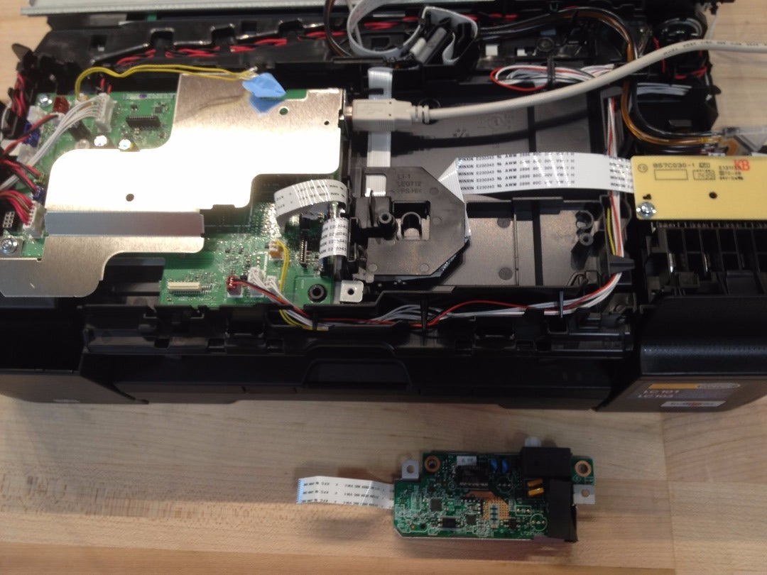

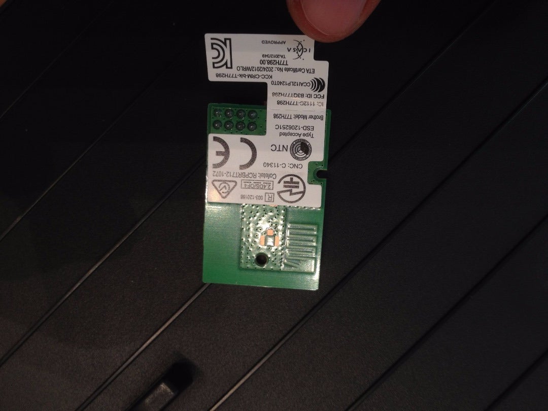

Step 15: LAN and Ink Cartridge PCB
Removing the PCB for the LAN connection and ink readings.

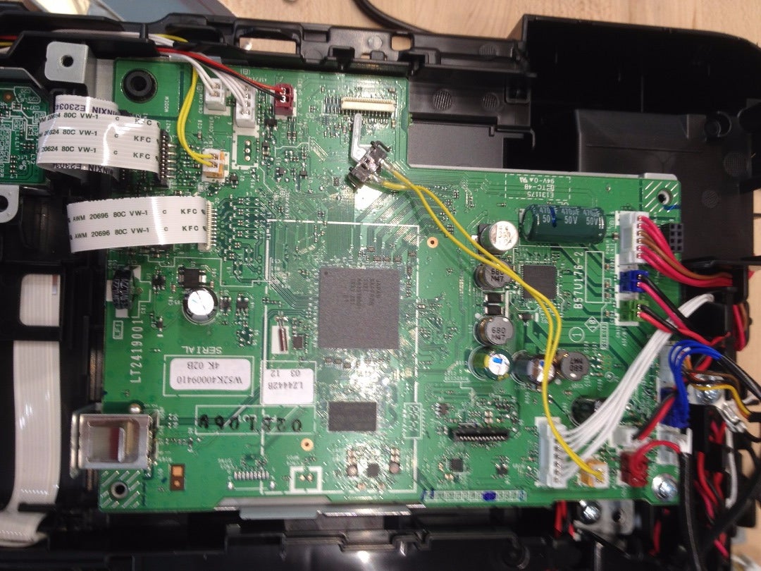

Step 17: Main PCB
Removed the main PCB

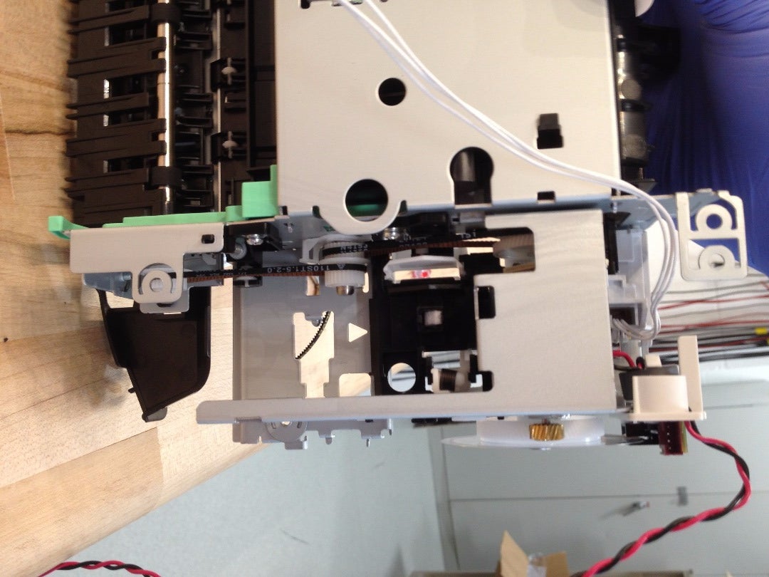

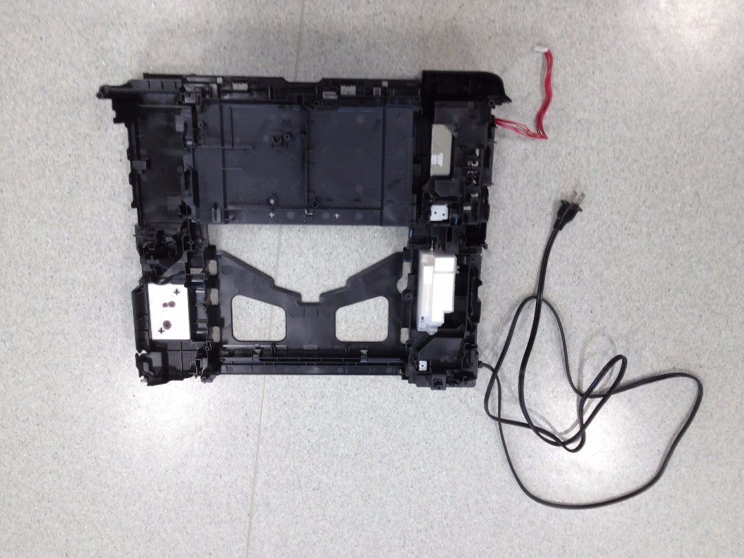

Step 20: Chassis Separation
Separated the chassis from the parts responsible for printing.

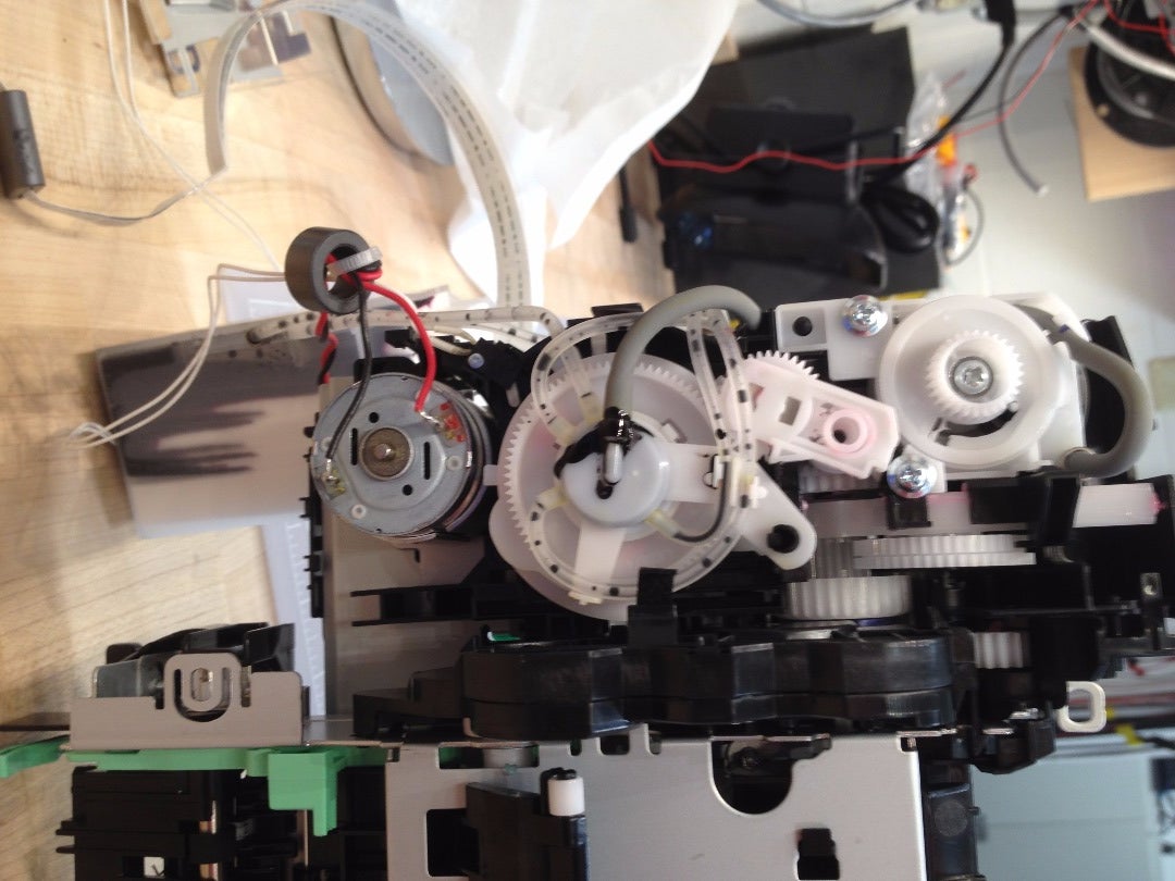

Step 21: Ink Pumps
Begin to remove the ink pumps

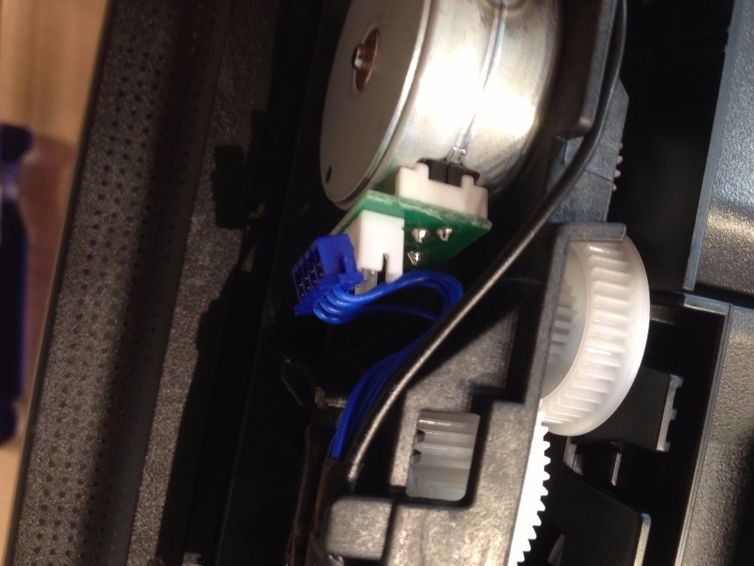

Step 23: More Framework Removed
Step 24: Paper Tray Motor
Step 25: Removing Bulk
Step 26: Removed Motor
This motor has an attached encoder.
