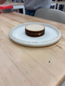

Step 1: Casing
For this prototype, I laser cut a birch casing to hold all of the components. It consists of layered rings with a cap piece on top that is taped down. This is the biggest area of improvement as there is a lot of empty space inside the current casing. Using a 3D printed design could allow it to be more compact and lighter. To hold all components inside of the casing, there is double sided tape to hold the gyroscope still.

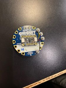

Step 2: Wiring
The wiring for this is very simple. The STEMMA QT cable connects from the gyroscope into the Ground, 3.3V, SDA, and SCL ports on the Bluefruit. I cut the cables to be and screwed them into the ports to keep the design as compact as possible. The battery is plugged into the Bluefruit's power port.
