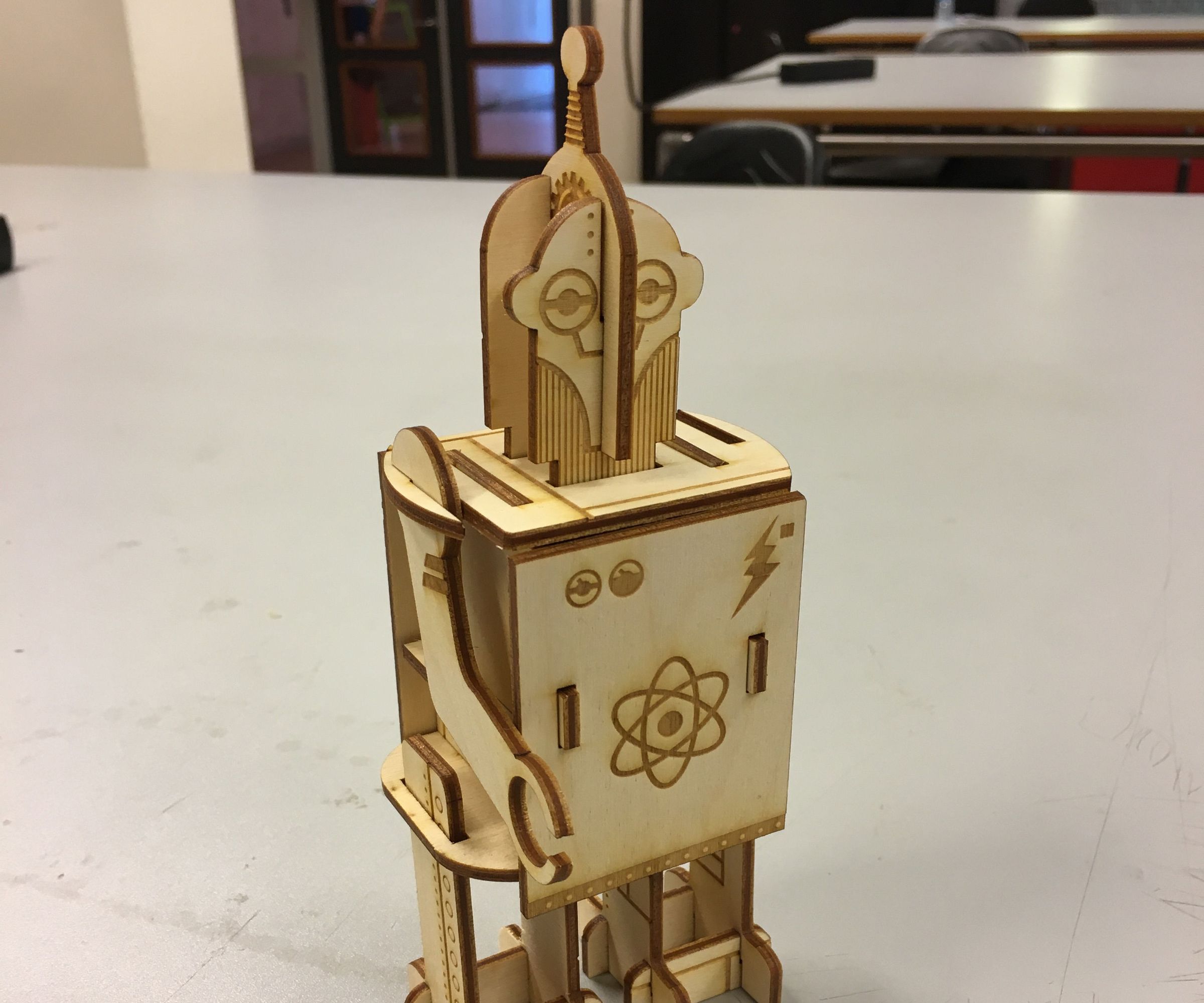

Step 2: Assembly of 'post-it' Holder
Gather all parts as seen in picture1.
Tools: wood glue, glue clamp, wooden hammer.
Follow steps in order of pictures.
Step 3: Assembly of 'pencil' Holder
follow examples in picture 1 to 5.
these assembly steps are done with the object turned upside down.
extra instruction for picture 5: after adding wood glue > flip the object 180 degrees so that the object is not upside down anymore.
Step 4: Assembly of Pencil Holder to Baseplate
assemble the pencil holder on the baseplate.
(baseplate is best seen in picture 2 > underneath the pencil holder)
Step 5: Assembly of Post-it Holder to Baseplate
follow examples in picture 1 to 6.
