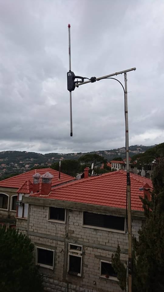

This is my first time on instructables.com, so I am a newbie here, sorry not being very meticulous in expressing the steps correctly. Building this antenna is difficult in general and finding the right or perfect materials is even more difficult.
There are several antenna calculators online but I used this: https://www.changpuak.ch/electronics/calc_11.php
I was limited by the Aluminum rods of 99cm and needed to cut off the brand engraving so ended up with 97cm to start with. The aluminum rods are those used for welding.

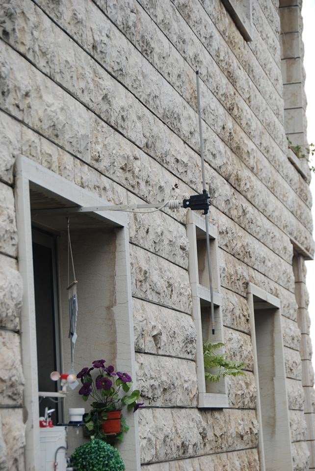

(Error: the dimensions in the 2nd image are "cm" not "mm" (image is 1/10th scale)
Solder a copper wire to the middle element to the SO-239
Make sure to add an insulation of about 1 cm or less (I used 3 inner tire tubes that added up to about 8mm of thickness)
Cut through the rubber to let the plastic PC Spacers pass easily and then tighten the top disc with the bottom cone with plastic zip ties. And surely a middle thin hole for the copper wire to pass
Solder the copper wire to the top element (disc)
Screw the bottom element (Cone) to the open Aluminum box (holde) As you see best fits.
Step 4: Finalizing
After assembling all the parts and screwing the box (base) to the holders, you will need to add the bits and pieces of the truncating tube to almost the middle of reflectors (at almost 30 to 40 cm measuring from the top). This design is a bit flimsy and the truncating pieces would hold the cone reflectors from wobbling.
Although not intended for TX but rather as RX to be used with the RTL-SDR dongle as a scanner, but humbly it proved to have an SWR 1.5 @140.000 Mhz and SWR 2.0 @ 150.000 Mhz.
