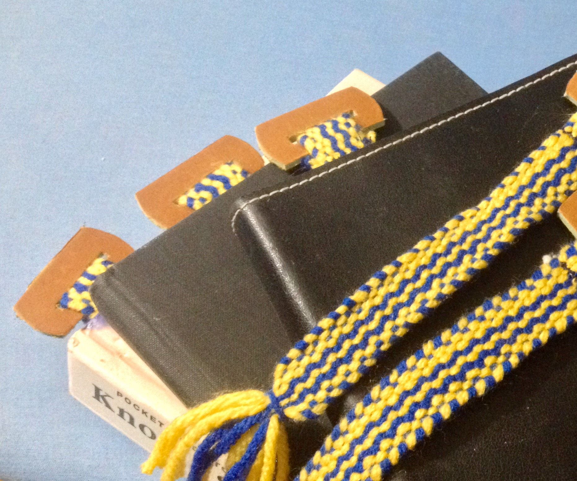

Introduction: Discover and Build an Inkle Loom!
I've been thinking about weaving for a while as something I might enjoy to pass the time or teach my children. The weather is getting colder lately and I'm finding more excuses to lay about in the warm house. One problem with weaving is that it can be extremely cost prohibitive. The artist may spend many thousands of dollars on weaving kit which takes up a lot of space. For me, space is at a premium and I hesitate to spend time and money on an introductory weaving course which I may not actually enjoy, just to have access to a loom.
I was looking around at various types of weaving and different types of looms when I came across Inkling. It is commonly used for weaving narrow bands and has been around for centuries. At first look, I thought it was limited by what it could produce and couldn't hold my attention for long. On the contrary, Inkle weaving seems to have a very low cost of entry for amazing versatility. Many different techniques can be demonstrated on this loom. Bead work, wire weaving, card and tablet weaving, picking, and probably many other techniques can be applied to produce everything from single color utility straps to truly mesmerizing patterns in a range of materials from the finest silk thread to the coarsest fibers. One of the warps pictured, is regular 100% acrylic yarn. The other warp is made with "yarn" cut from strips of old t-shirts.
Luckily, a ton of online information is available on Inkle weaving. Please be encouraged to search around and see if Inkling might be something you'd enjoy-- Then, come back here and build an Inkle loom!

My first projects are off of the loom! I am very pleased with the whole process. The loom is fun to make, enjoyable to use and weaving is just as gratifying as I suspected it might be. The tricky part now is that I just can't stand to have the loom sitting idle!
