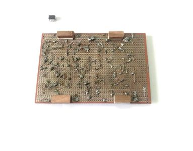

Here is a discrete transistor-level replica of the IC-555.

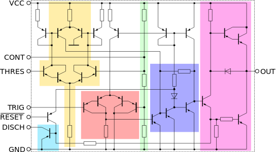

Step 1: Understanding the Block Diagram
The internal block diagram and schematic of the 555 timer are highlighted with the same color across all the drawings to clarify how the chip is implemented:-
Voltage divider
Between the positive supply voltage VCC and the ground GND is a voltage divider consisting of three identical resistors (5 kΩ for bipolar timers) to create reference voltages for the analog comparators. CONTROL is connected between the upper two resistors, allowing an external voltage to control the reference voltages:
When CONTROL is not driven, this divider creates an upper reference voltage of 2⁄3 VCC and a lower reference voltage of 1⁄3 VCC.

Step 2: Internal Circuitry of 555 Timer
Darlington Pairs
One of the first things to notice is that some of the transistors (e.g., Q1 and Q2) are hooked up together in what is known as the Darlington configuration. The emitter of one transistor is connected to the base of another. This effectively makes one new “super transistor” out of the two, since it is the amplified current out of the first collector that serves as the base current for the second transistor. If the gain of a single transistor were 30, then the effective gain of the Darlington pair would be 30 × 30 = 900. Since there are two transistors, there are also two diode drops to be overcome; the Darlington pair will not begin to turn on until its base is at least 1.4 V above the emitter.

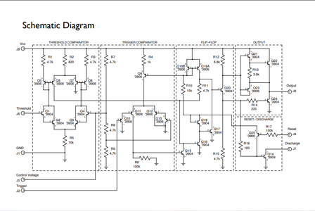

Differential Amplifier
Two Darlington pairs, Q1/Q2 and Q3/Q4 form a differential amplifier. Using the Darlington pairs reduces the current drawn from the comparator inputs. When the voltage on the threshold input is higher than the voltage on the reference input (⅔ of Vcc), the current flow in the circuit comes mainly from the left side through Q1 and Q2. When the threshold voltage falls below the reference voltage, the circuit changes state, and the majority of the current flows through Q3 and Q4. We can help illustrate the main idea with a simplified differential amplifier: In the case on the left, the inputs to the amplifier are 2 V (left input) and 1 V (right input). Since the left input is higher, the left transistor turns on more strongly, pulling more current through its collector. The voltage at the emitter saturates to 1.4 V, turning off the other transistor. If the inputs change to the case on the right, when the inputs are 1 V (left input) and 2 V (right input), the opposite happens, and the current flows down the right hand of the circuit. In these two cases what you should notice is that current is always flowing but the branch of the circuit (left or right) that it flows through depends upon the values of the input voltages. Regardless of which set of transistors conduct the current through the differential amplifier, the current always travels through R5 to the ground. Because of the Darlington pairs, the voltage drop from each input to the top of R5 is two diode drops. For proper operation, at least one of the inputs must be at least 1.4 V above ground. Since the other comparator input connects to ⅔ of Vcc, this condition is satisfied.
Current mirrors
Before we get to Q5, Q6, Q7, and Q8 at the top of the threshold comparator block, we must digress for a moment to describe a circuit block called a “current mirror” that appears repeatedly both in this section and elsewhere in our overall schematic. A current mirror is called that because it “copies” a current through one circuit element to a current through another element. Let’s first examine a relatively simple example of a current mirror. Look at how Q19A and Q19B are wired up: Notice that transistor Q19B is connected “as a diode,” with its base short-circuited to its collector. Even so, it allows current to pass through its collector. Since their emitters and bases are wired together, both Q19A and Q19B have the same base-emitter voltage. Symmetry then dictates that the same amount of current should flow from the emitter to the base of each transistor. Accordingly, both transistors permit the same amount of current to pass through their collectors. If current IQ19B is sourced from the collector of Q19B, the same amount of current will flow through the collector of Q19A: IQ19A = IQ19B. In this sense, the current through the collector of Q19A “mirrors” that of Q19B.
Second Stage Differential Amplifier
The outputs of the first differential amplifier in the threshold comparator feed into a second differential amplifier formed by transistors Q5, Q6, Q7, and Q8, with resistors R1, R2, and R3. This differential amplifier looks different for a couple of reasons. First, it is “upside down” when compared to the one that we looked at earlier. Second, its input stages are current mirror circuits. However, it works using the same principle: it amplifies the signal coming from the first differential amplifier and increases the overall gain. One current mirror is formed by Q5, Q6, R1, and R2. Another is formed by Q7, Q8, R2, and R3. Transistors Q6 and Q7 do double duty – they are part of the current mirror circuit but, working with R2, also act as a differential amplifier. The collector of Q6 is the output of the amplifier and gets routed to the flip-flop block. Q7's collector goes to ground and is not used but it could be considered the "inverted" output. In essence, this part of the circuit is three circuits superimposed on each other: Two current mirrors mashed up with a differential amplifier.
The Flip Flop
There is a lot of analog subtlety in this block. It is known as a bistable circuit because it has two stable states. To simplify the analysis, we will look at the block in its two possible states: where the output pin is either on or off. The bias current for this block comes from the current mirror pair Q19A/Q19B. R10 sets the current through Q19B and consequently, through mirrors Q19A and Q9. (Recall that Q9 is the transistor that provides the constant current source for the trigger comparator).
Output Stage
Q20 takes the raw output of the flip-flop gate and creates a buffered (non-inverted) version and an inverted version of the signal. It will also help to analyze the circuit in two states.
Reset Input
Pulling the reset pin low turns on Q25. This steals current from the flip flop, putting it into the on state (for which the output pin is low), and uses that current to switch on Q14 and Q24, which drive the output pin and the discharge pin low. Resistor R17 is not in the original 555 timer integrated circuit. It has been added to help protect the reverse-biased junction of Q25.Q25 has a maximum reverse bias voltage on the base-emitter junction of only 6V, whereas the original 555 could handle 18 V. Therefore, when the Reset pin is tied high and the Vcc is high enough, it is possible to exceed this breakdown voltage, and R17 prevents damage by limiting the current.

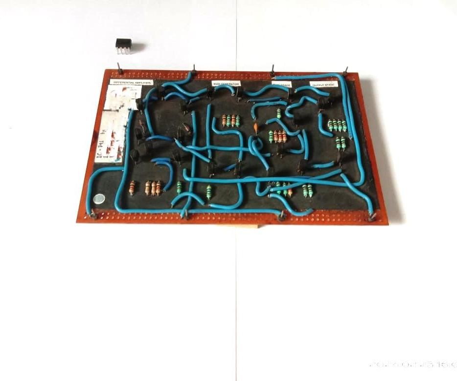

Step 3: Building the Project
1) Make the connections as per the circuit diagram.
2) Test every component before using.
3) Mount the circuit first on the breadboard.
4) With the reference circuit, make the permanent connections.
5) Double-check every connection.
Step 4: Testing
The test circuit is 555 astable multivibrator.
Connect an LED in series with a 470R resistor at the output.
Since discrete transistors cause large output voltage swings, follow these guidelines:-
1) Use a capacitor of 470uF across the power rail.
2) Use R1 = R2 = 220R and C = 1000uF (Use large value of C).
The output high time interval of each pulse is given by,
Th = ln(2) x (R1 + R2) X C = 0.305s
Tl = ln(2) X R2 X C = 0.15s
f = 1 / (Th + Tl) = 2.183Hz
%D = Th / (Th + Tl) = 66.594%
