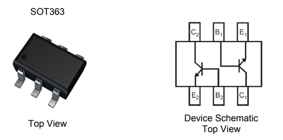

What to some extent differentiate this design is the adoption of a NPN transistor pair in a single SMD package. This has the advantage of an intrinsic good matching of the transistor pair and a less tendency to drift over time thanks to a far better junction temperature pairing (they are in the same package, after all).
By using good quality metal thin film resistors in the differential pair part of the circuit (the two 10K resistors referencing the transistors to V+) should be enought to delete the otherwise necessary transistor pair testing and selection phase (it was for me!).
No improvement comes without a price, unfortunately: the chip (BC847BS) is in SOT363 package, which means it is almost invisible (0.65 mm pitch!). See next step for some soldering tips.

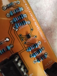

To solder the microbe (A.K.A. BC847BS) you have to adopt some strategy. My suggestions are:
- solder the BC847BS first. You will need space around your solder tip and you don't want to waste other components in case of problems.
- use a thin iron to solder the chip and a scanning electron microscope (just kidding! A magnifying glass will suffice)
- use some soldering flux. I use a cheap "no-clean" Rosing Mildly Activated (RMA) pen with excellent results
- soldering method #1: melt a little amount of solder on the board pads, place the transistor pair over it and then remelt the pad-solder with a clean iron tip while applying a veeeeery small pressure on top of the IC.
- soldering method #2: melt a little amount of solder on the board pads, place the transistor pair over it and then melt a solder blob (yes...) over the ICs pins. Make sure that the blob touches all pins. Now, remelt the solder blob and remove it with a desoldering pump (one of those cheap desoldering pens with spring will work perfectly).
The soldering method to be used depends on a load of factors (equipment in use, operator skills, etc. etc.) but also on the dimensions of the IC and pads you are going to solder it on. In this very specific case, I had the best results with method #2, but test both.
Having the IC well soldered could ask for some trial and error at first, but believe me: if I can do that, you can. As a precaution and giving the limited cost of such IC (at today 10pcs costs less than 1 euro), buy a little bunch of them.
I placed some vias close to each feet of the IC: use them for continuity checks with chip's feets.
Notice that the chip can be soldered in both directions, therefore it is useless to lose diopters in search of the right one :)

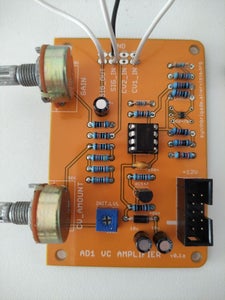

You can have your PCB manufactured at the following link (PCBWay):
https://www.pcbway.com/project/shareproject/Discre...
Select a nice color, place your order, have it shipped to you, source components, assemble it and have fun in th process!
The board is intended to be mounted perpendicular to the front panel. If your case is not deep enought, you can lock the board on the case bottom and use wires to gain electrical connection with elements (potentiometers, buttons, jacks and so on) on the front panel.
The circuit is very simple and asks for a limited amount of components. All components values are silkscreened on the PCB to make assembly easier.
