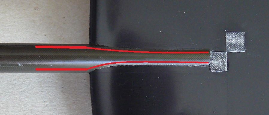

The Blaster 2 has an all moving tailplane mounted on a carbon V mount. The mount has to be fitted before the rudder as it slips over the boom.

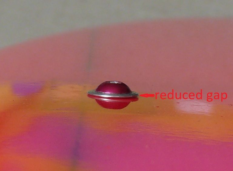

I noticed that the attachment screw did not rest flat on the upper surface of the tailplane/elevator. This was because the V mount assumes parallel top and bottom surfaces and the elevator was essentially triangular in cross-section from the mounting plate to the trailing edge. To correct this I filed a piece of 0.5mm carbon sheet to make a wedge and glued this onto the mounting plate bottom surface. See photo above. I rounded all the edges of the V mount to hopefully lose a tiny bit of weight and drag (I don’t suppose very much).
After the mod the screw presses more evenly on the top of the elevator:

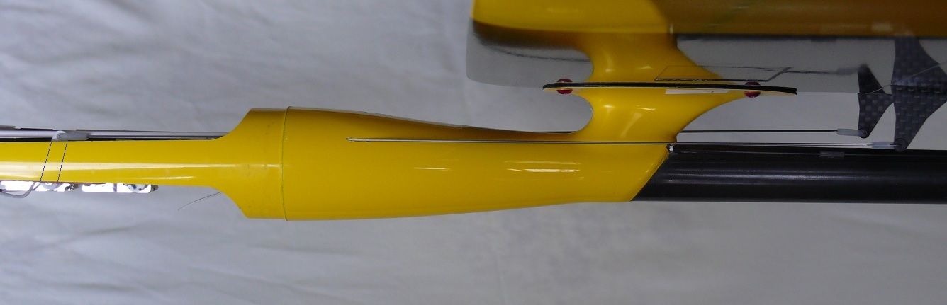

The rudder glues into a slot the rear of the carbon tail boom. Unfortunately the slot in my kit was not vertical. I explored options, including getting a replacement fuselage, but the rudder was also a little thicker than design and it looked like careful trimming could lead to a fit. So I decided to proceed. This would leave the tail a little weaker with thinner pieces of the carbon boom either side of the rudder. So I added two 60mm lengths of 1mm2 carbon tow starting inside the top and bottom of the boom and the splitting each of these so half ran down each side of the rudder, still inside the boom. Tricky but worked OK. See photo below for the positioning of the carbon tows.
I again used epoxy. I had masked off the rudder around the joint and the outside of the boom before assembly to aid removal of a small amount of surplus adhesive. This also helped giving a minimal sanding of the rudder side of the joint to remove the gel coat and get a better joint.
I have described this as if done after the elevator mount. However given the uncertainty on whether I would get the rudder vertical I did the filing of the rudder slot first and then fixed the elevator mount, followed by gluing the rudder in place. Hence in order to sand the rudder slot vertical I had to use a straight edge on the main wing mount as a reference – having also checked that this was representative of the main wing position. It would have been easier to have fixed the elevator mount first and used this as a reference to get the rudder upright.

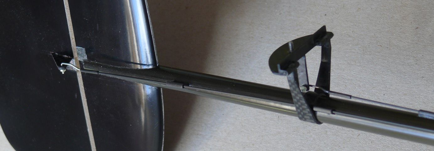

The tail control rods are 0.8mm diameter carbon rods. The design has these running on the outside of the tail boom. It would look much neater if these were inside. However after much thought I stuck with the outside as the internal option would end up heavier and weaken the boom where the rods exited. The design has the rods guided by a series of 10mm long tubes at around 50mm spacing. I was however not happy with using the supplied plastic guides as my experience of gluing to plastics is poor. So I decided to use 2mm OD carbon tubes (1mm ID) and file a flat on one side to both get the rods closer to the boom and provide a flatter surface to glue and hence save a tiny bit more weight. I also reduced the guide length to 8mm and increased the spacing to 55mm to save a bit more weight.
In order to get these guides aligned I cut pieces of masking tape with a hole just bigger than the guides and carefully placed these on the boom before gluing the guides in place. I also used a piece of 1mm carbon rod to aid alignment. I started by fitting the guides next to the elevator mount. I could then use a straight edge from here to the tubes at the front of the boom to place the pieces of masking tape. I then progressed fitting one guide at the front and one at the back and then, after waiting to set, moving on to the next pair, gradually getting to the middle. The photo above shows the last of the main rudder control rod guides being fitted. I then made up an offset guide to give some support between the elevator mount and the rudder horn. This was fitted later when I knew what pushrod movement I could get from the servo and hence the size of the rudder horn, and hence the amount of offset required:

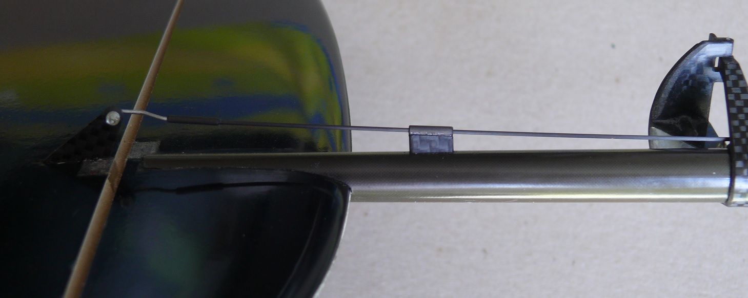

The all moving elevator link was straightforward (well something had to be!). I raised the last guide 0.5mm to help give a smooth run to the horn:

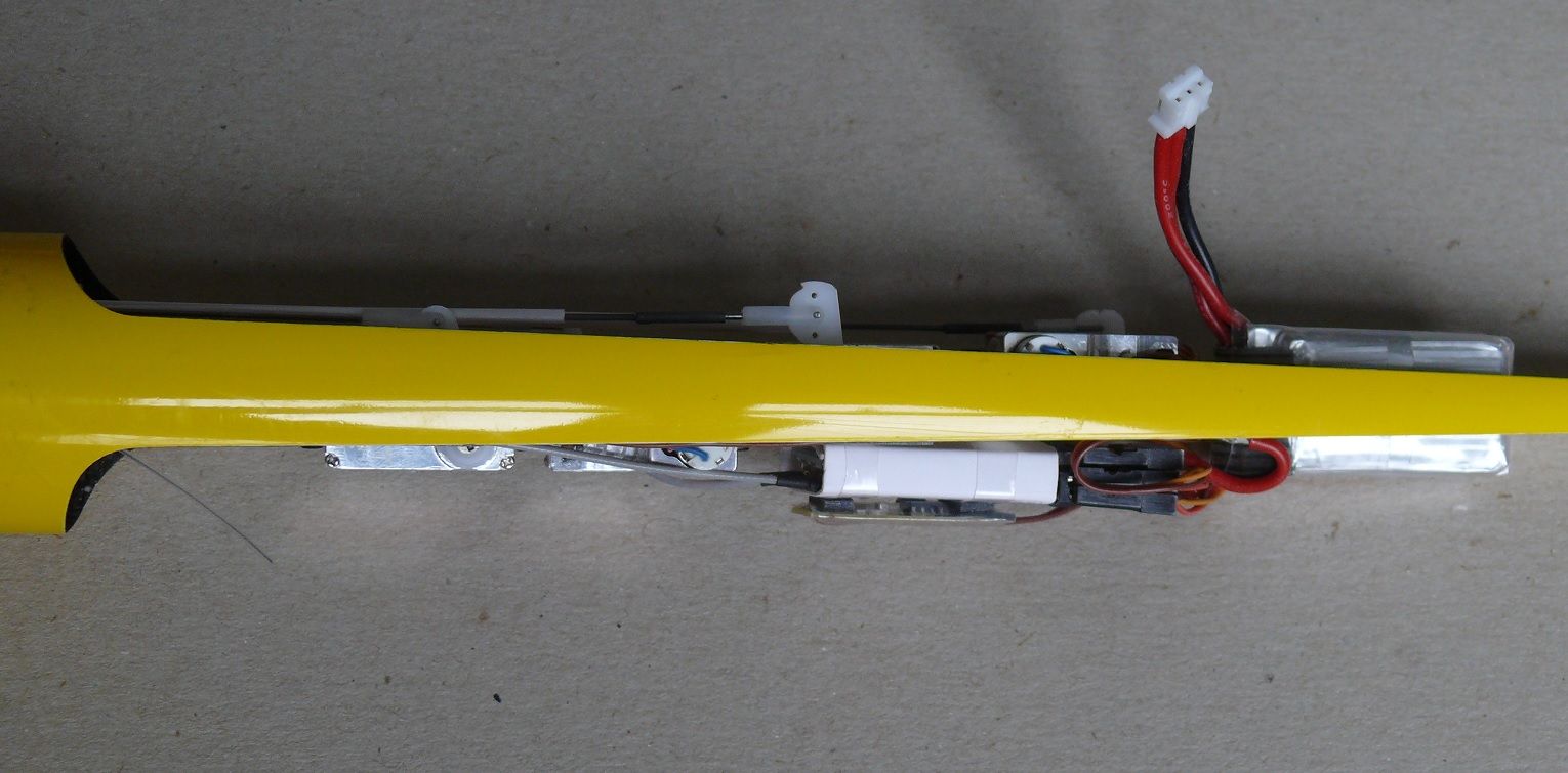

Step 4: Servo Arrangement
This took quite a while to design. The aim was to have the servos as far forward as possible to minimise the need for nose weight.
The battery would be furthest forward. So the first question was ‘which battery was I going to use?’. A 380mah 2 cell lipo would be big enough. I had already decided that I would use high voltage servos. This avoids the need for a voltage regulator – that then saves space and weight and also means a smaller capacity battery can be used (no energy loss from the regulation).
I had also already bought the servos and had opted for the version designed for mounting flat rather than upright (KST X08H v3 HV). These are designed for mounting in wings – that was no longer my plan! However mounting servos horizontally rather vertically also makes good use of the space in a nose cone.
I then did a bunch of drawings with servo positions, potential servo arm lengths and push rod routes. I double checked space using pieces of card with different diameter holes for nose diameters at the servo positions. At first I had the rudder servo most forward as this would enable the pushrod to pass over the elevator servo. The rudder servo arm needs to be fairly long for the large rudder movement while the elevator servo arm is short with the small movement of the all moving elevator. I disbanded this when I realised that the pushrod would need to be more than the standard 1m length. So the elevator servo had to go in front and the rudder servo set into the 2mm thick servo tray (but not through it) so the elevator pushrod could pass over it.

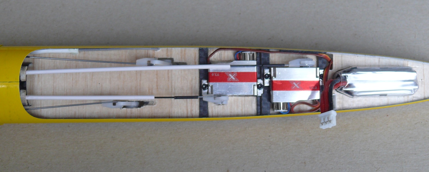

The aileron servos needed arms as long as possible and hence could be installed underneath the servo tray with their arms going upwards through holes in the tray.

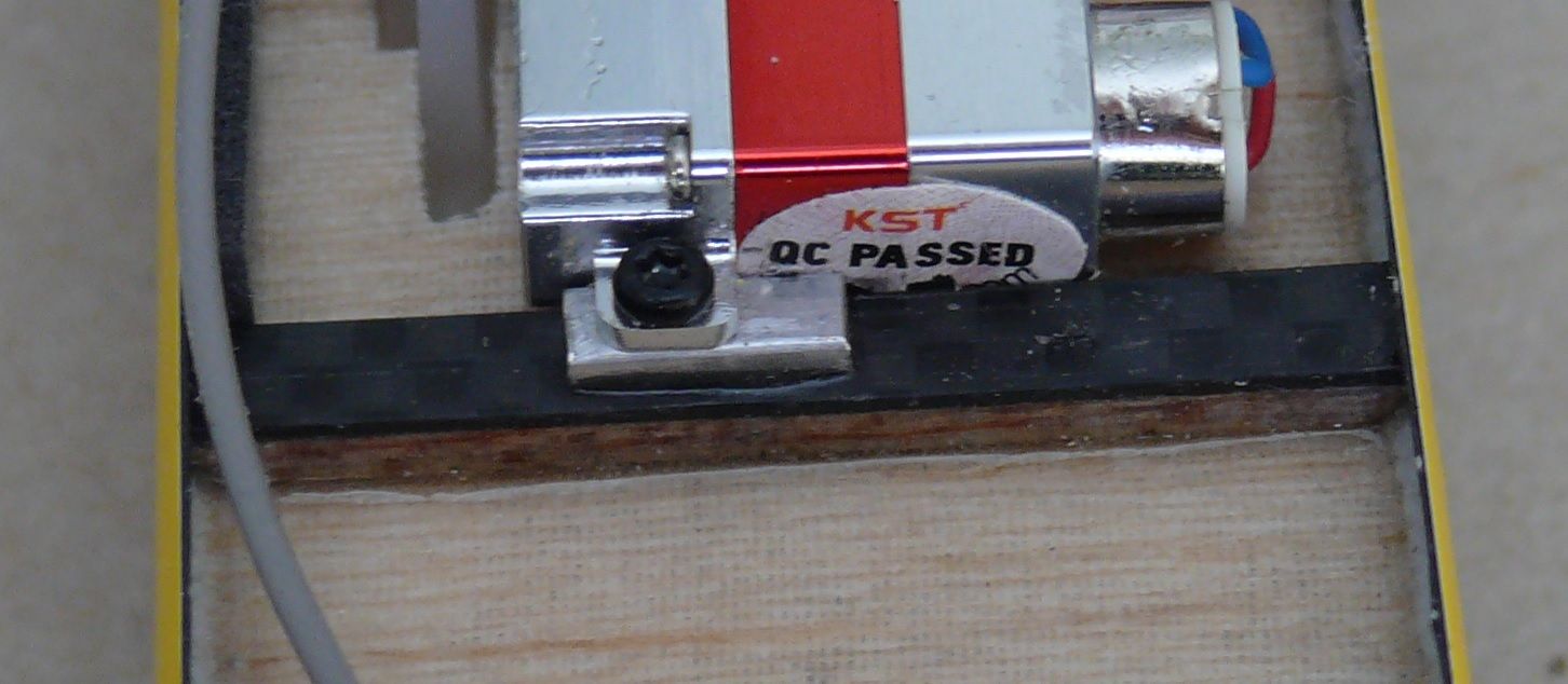

DLG servos are traditionally mounted by wrapping in tape and then gluing in place. This looked too messy and heavy to me, plus not easy to remove the servos if they fail. So I decided to use 4mm wide strips of 0.5mm carbon sheet to span the servo tray at each mount and then epoxy small aluminium blocks tapped for a #0 UNF screw that was the right size for the servos. I had the screws from a 250 size helicopter. The carbon strips had pieces of balsa underneath to raise them to the height required. See photo below:

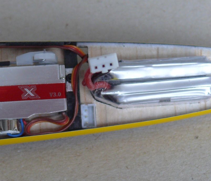

The elevator and rudder servos where mounted on top of the servo tray, behind the battery:
The aileron servos were mounted in the underside of the servo tray:
Here is a horizontal view:

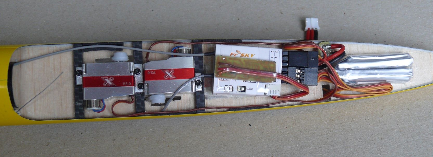

I had already fixed the battery location and there was space for the receiver on the underside of the servo tray, below the rudder and elevator servos. There was also room for my very small altimeter/variometer next to the receiver. I use FrSky radio with their excellent telemetry system. The question then was where to place the aerials. I could place one behind the aileron servos pointing away from the carbon parts of the nose. See above. The only option for the other was to get a long aerial lead and place it in the wing. I made a paper tube the right diameter and epoxied it in at an angle so it would be 90 degrees to the aerial in the nose:
I made up the battery from a couple of single cells and fitted a balance plug that could be used both for charging and for supplying power the radio.
Rather than use an on/off switch I glued a socket into the servo tray. Hence powering up is just a matter of removing the nose cone and plugging the battery in:
