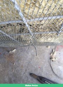

Step 11: Preparing for Stucco
Wired lattice to the structure to support stucco. The more wires the better. No stucco till I do a fire/cook test run
