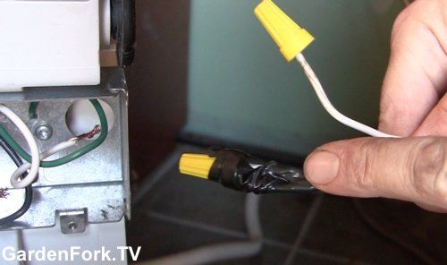

After you remove the dishwasher and remove the power wire from it,
put wire nuts on the exposed wires and wrap electrical tape around the hot ( black ) wire to keep it from coming off. There will be water in the supply and drain lines, be sure to have a bowl handy.
