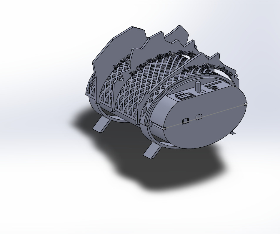

This Dish Rack was made from materials sourced from an old DVD player and some 3d Printed Parts.
This was created as part of coursework for IDN1002.

Step 5: Assembling the Disk Rack
Attach the stand and top cover to the base. This can be done with the use of super glue. We used bits of the power cable as hinges, as they provided enough flex for the rack. Finally, attach the spreaders to the top plate.
The rack is now complete.
