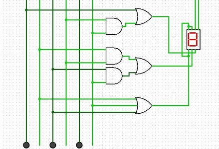

Step 6: Build the Circuit on Logisim
To build a circuit automatically, in logisim go to
1) window>combinational analysis
2) set the 3 inputs according to the truth table
3) set the outputs
4) press the cross buttons to set either 0 or 1
5) press build circuit
6) set a name, and preferably select the only two input gates
7) the circuit will be build successfully
Step 7: Modify the Circuit(optional)
Connect the seven-segment display to see if the circuit works properly. You can modify the circuit to make it simpler. Like I removed the connections for e, f, and g since they have the exact same output and connected them together with one wire.
