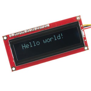

Step 3: Set Up LCD Screen

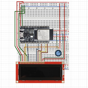

Now that we know the air and water values for the moisture sensor, we can set up the LCD screen. Remove everything from the breadboard.
The ESP32 doesn't fit cleanly onto a single breadboard with the LCD screen. I recommend placing the ESP32 between two connected breadboards so that it bridges from one board, over the power rails, onto the other. This will allow us to use both sets of pins on the ESP32.
Wiring the LCD
We will be using pins 15,2,19,21,22,23 on the ESP32 to connect to the LCD. The LCD also requires a potentiometer to allow us to adjust the contrast on the screen.
Refer to the wiring diagram provided and recreate it on your board. Red is power and green/black is ground, other colors go to pins.

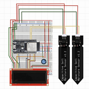

Now that the LCD screen is hooked up, we can add the capacitive soil moisture sensors from earlier.
Wiring the Moisture Sensors
To do this, we will be using pins 34 and 35 of the ESP32. Attach each sensor to both ground (black/green wires) and the power (red wires) on the top power rail, and wire one sensor to pin 34 and the other to pin 35. We'll call these sensor 1 and sensor two respectively. Refer to the diagram attached for help.
