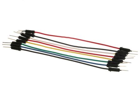

- Jumper wires

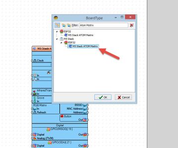

Step 3: Start Visuino, and Select the Atom Matrix Board Type
Start Visuino as shown in the first picture Click on the "Tools" button on the Arduino component (Picture 1) in Visuino When the dialog appears, select "Atom Matrix" as shown on Picture 2

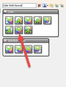

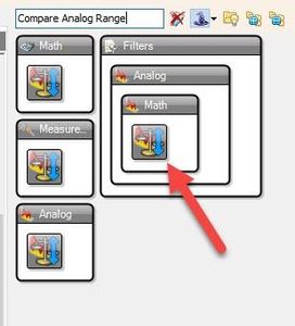

- Add 3X "Compare Analog Range" component

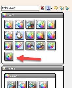

- Add "Color Value" component
- Add "Color Multi Source" component

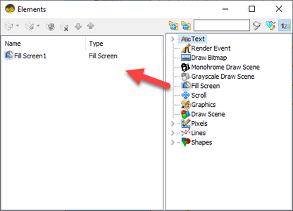

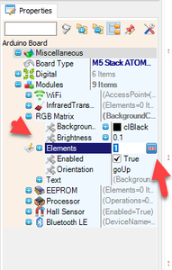

- Select "M5 Stack ATOM Matrix" board and in the properties window expand "Modules">"RGB Matrix">"Elements" and click on the 3 dots button

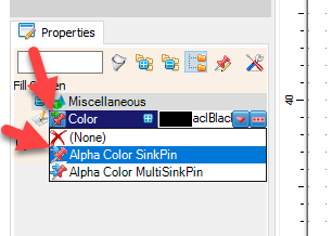

- In the "Elements" window drag "Fill Screen" to the left side and in the properties window select "Color" and click on the Pin Icon and select "Alpha Color SinkPin"
- Close the "Elements" window

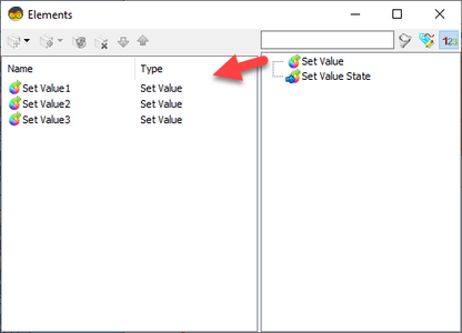

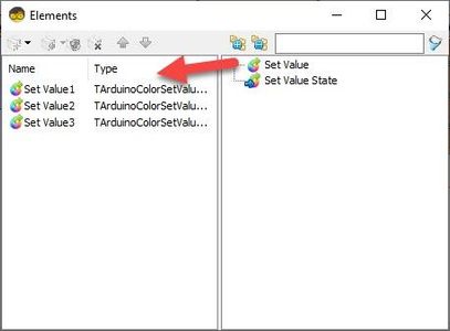

Double click on the "ColorValue1" and in the Elements window:
- Drag "Set Value" to the left side and in the properties window set "Color" to clBlue
- Drag another "Set Value" to the left side and in the properties window set "Color" to clGreen
- Drag another "Set Value" to the left side and in the properties window set "Color" to clRed
- Close the Elements window
