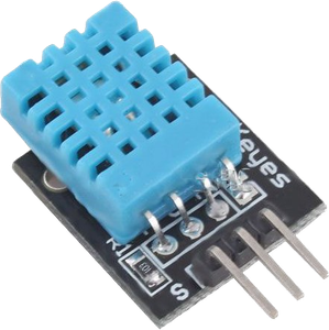

- DHT11 Temperature and Humidity sensor

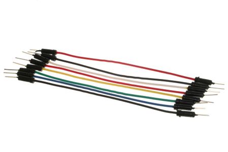

- Jumper wires
- Visuino program: Download Visuino
Step 2: The Circuit
- Connect DHT11 sensor pin [VCC] to Atom Matrix pin [5V]
- Connect DHT11 sensor pin [GND] to Atom Matrix pin [GND]
- Connect DHT11 sensor pin [S] to Atom Matrix pin [G25]

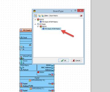

Step 3: Start Visuino, and Select the Atom Matrix Board Type
Start Visuino as shown in the first picture Click on the "Tools" button on the Arduino component (Picture 1) in Visuino When the dialog appears, select "Atom Matrix" as shown on Picture 2

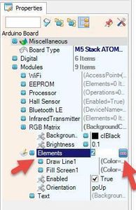

- Select "M5 Stack ATOM Matrix" board and in the properties window expand "Modules">"RGB Matrix">"Elements" and click on the 3 dots button

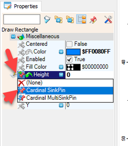

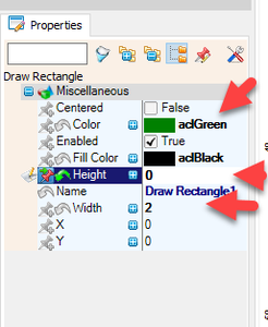

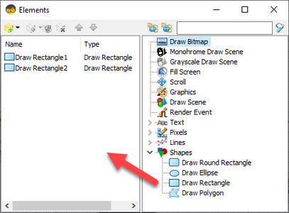

- In the "Elements" window drag "Draw Rectangle" to the left side and in the properties window select "Height" and click on the Pin Icon and select "Cardinal SinkPin", set the "Color" to aclGreen, "Width" to 2, "Height" to 0
- In the "Elements" window drag another "Draw Rectangle" to the left side and in the properties window select "Height" and click on the Pin Icon and select "Cardinal SinkPin", set the "Color" to $FF0080FF , "Width" to 2, "Height" to 0, "X" to 3
- Close the "Elements" window
