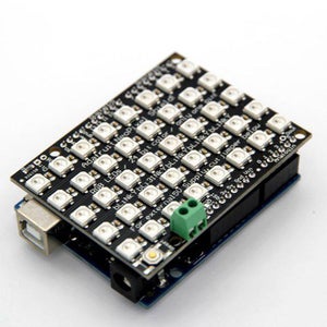

  • Adafruit NeoPixel Shield for Arduino - 40 RGB LED Pixel Matrix More Info
  • Arduino UNO
  • Visuino software: Download here
Step 2: The Circuit
Attach the Shield to Arduino Uno, You can find More Info here

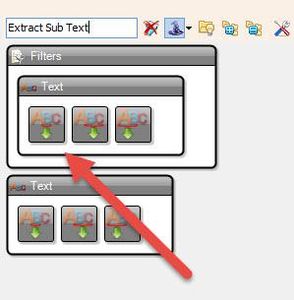

  • Add "Extract Sub Text" component

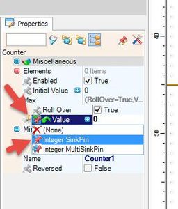

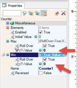

  • Select "Counter1" and in the properties window set Max>Value to 0 and Min>Value to 0, also select Max>Value and click on the Pin Icon and select "Integer SinkPin"

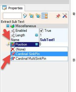

  • Select "SubText1" and in the properties window select "Position" and click on the Pin Icon and select "Cardinal SinkPin"

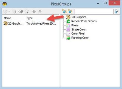

  • Double click on the "NeoPixels1" and in the "Pixel Groups" window Drag ""2D Graphics" window" to the left side and in the properties window set "Height" to 5 and "Orientation" to goRight

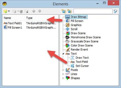

  • Select "Elements" and click on the 3 dots button

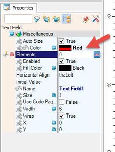

  • In the "Elements" window drag "Text Field" to the left side and in the properties window set "Color" to Red
  • In the "Elements" also window drag "Fill Screen" to the left side
  • Close "Elements" window

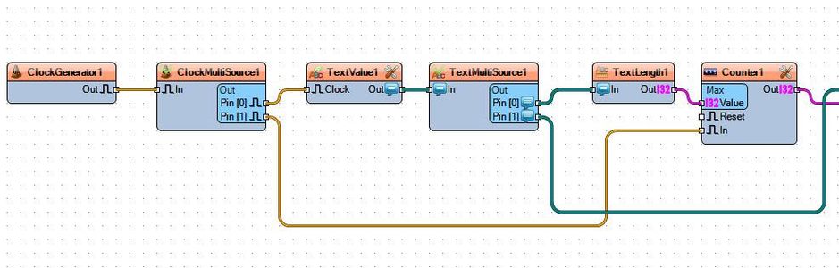

  • Connect "ClockGenerator1" pin [Out] to "ClockMultiSource1" pin[In]
  • Connect "ClockMultiSource1" pin [0] to "TextValue1" pin[In]
  • Connect "ClockMultiSource1" pin [1] to "Counter1" pin[In]
  • Connect "TextValue1" pin[Out] "TextMultiSource1" pin[In]
  • Connect "TextMultiSource1" pin [0] to "TextLength1" pin[In]
  • Connect "TextMultiSource1" pin [1] to "SubText1" pin[In]
  • Connect "TextLength1" pin [Out] to "Counter1" >Max pin[Value]
  • Connect "Counter1 pin [Out] to "SubText1" pin[Position]

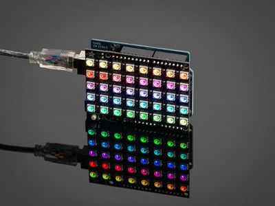

If you power the Arduino module the LED Pixel Matrix Pixels will start to Display the text.
