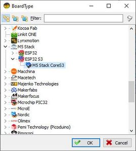

Step 2: Start Visuino, and Select the M5 Stack CoreS3 Board Type
Start Visuino as shown in the first picture Click on the "Tools" button on the Arduino component (Picture 1) in Visuino When the dialog appears, select "M5 Stack CoreS3" as shown on Picture 2

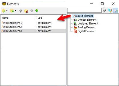

- Double click on the "FormattedText1" and in the Elements window drag 3X "Text Element" to the left side and close the Elements window
- Select "FormattedText1" and in the properties window set "Text" to: %0:%1:%2
(Where %0 represents TextElement1, %1 represents TextElement2, %2 represents TextElement3)

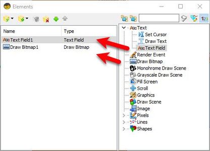

Step 4: In Visuino Set M5 Stack CoreS3 Display

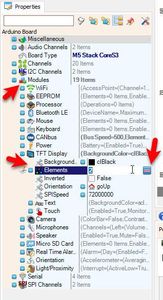

- Select "M5 Stack CoreS3" board and in the properties window expand "Modules">"TFT Display">"Elements" and click on the 3 dots button

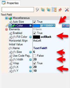

- In the "Elements" window drag "Text Field" to the left side
- In the "Elements" window drag 6X "Draw Scene" to the left side, and in the properties window set "Color" to $FF0080FF ,"Fill Color" to aclBlack, "Size" to 6, "Width" to 20, "X" to 20, "Y" to 10

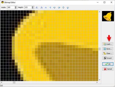

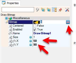

- In the "Elements" window drag "Draw Bitmap" to the left side, and in the properties window set "X" to 50, "Y" to 90, Select "Bitmap" and click on the 3 dot button and in the Bitmap Editor Load the bitmap that is attached above (the Bell)
- Close All the windows
