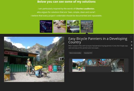

Ever wanted to display your instructables in a stylish way in a gallery, (including photos from multiple steps in mini galleries) - while loading all the content from your feed so you don't have to update it? This script helps you load your instructables dynamically into a grid using RSS/XML and display them, including some of their images in a mini gallery, modeled after google image search. How is this different from other similar applications? This modified a grid plugin and loads a description as well as thumbnails of the project (in a mini-gallery) on mouseover of the thumbnail.

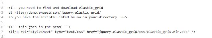

Step 3: Your Header
You need to create a .php file (you can just create this in notepad, same as you would an html file, if you didn't know/aren't familiar with using php). Copy/follow the code on the elastic_grid demo.
Make sure the code example above or in the github gist is in the header portion of your file

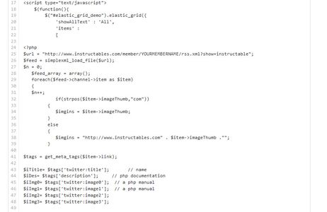

Step 5: The First Part of the Instructables Code
This needs to go where you want to display the gallery of your instructables. This portion of the code loads the RSS feed of your instructables account (or whatever's account the username corresponds to) and assigns each item (each "entry", your projects) to variables we can call in the next step

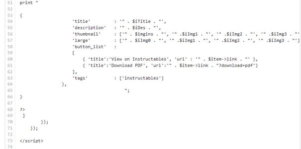

This "prints" the variables we just assigned in the last step as part of a loop and displays your content

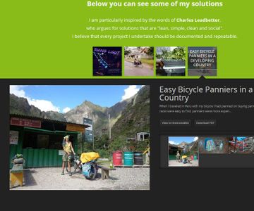

Step 8: Check Out Your Instructables Gallery!
See how it works and modify it as needed for your needs!
