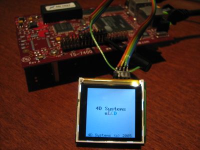

Step 1: The Hardware
The screen is the 'uLCD-128' from 4D Systems. I bought mine online from a company called Dontronics. This version has an extra 1MB of flash memory onboard, but it's not used in this prototype. The LCD has a serial interface and a well documented API, which makes interfacing quite easy.
The brains is a "system on module" called the TS-7400 from Technologic Systems. For less than $100 this little marvel runs Debian Linux and has a multitude of connectivity options: USB, ethernet, DAC, GPIO.
This project made use of one of the onboard serial UARTs. Both the TS-7400 and the uLCD have serial ports at logic (3.3v) levels. This makes wiring the two together a breeze as no interfacing circuitry is required.
