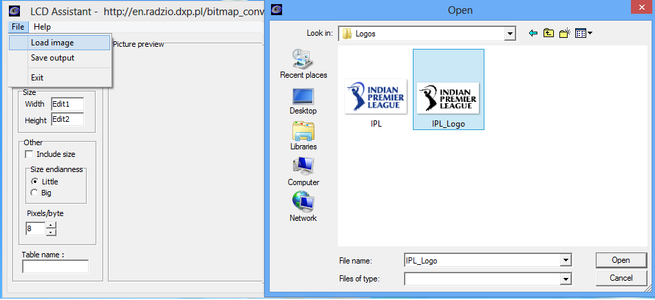

Step 2: Bitmap Using Lcd Assistant :
Now run the LCD Assistant software and load the monochrome image saved in the previous step.
Do the setting as shown in the second image.
Click on FILE->Save Output and save the output file as logo.txt .
The bitmap for the image will be saved in an array as shown in the 4th image.
Use this array in your code for displaying the image/logo on the graphic display.
