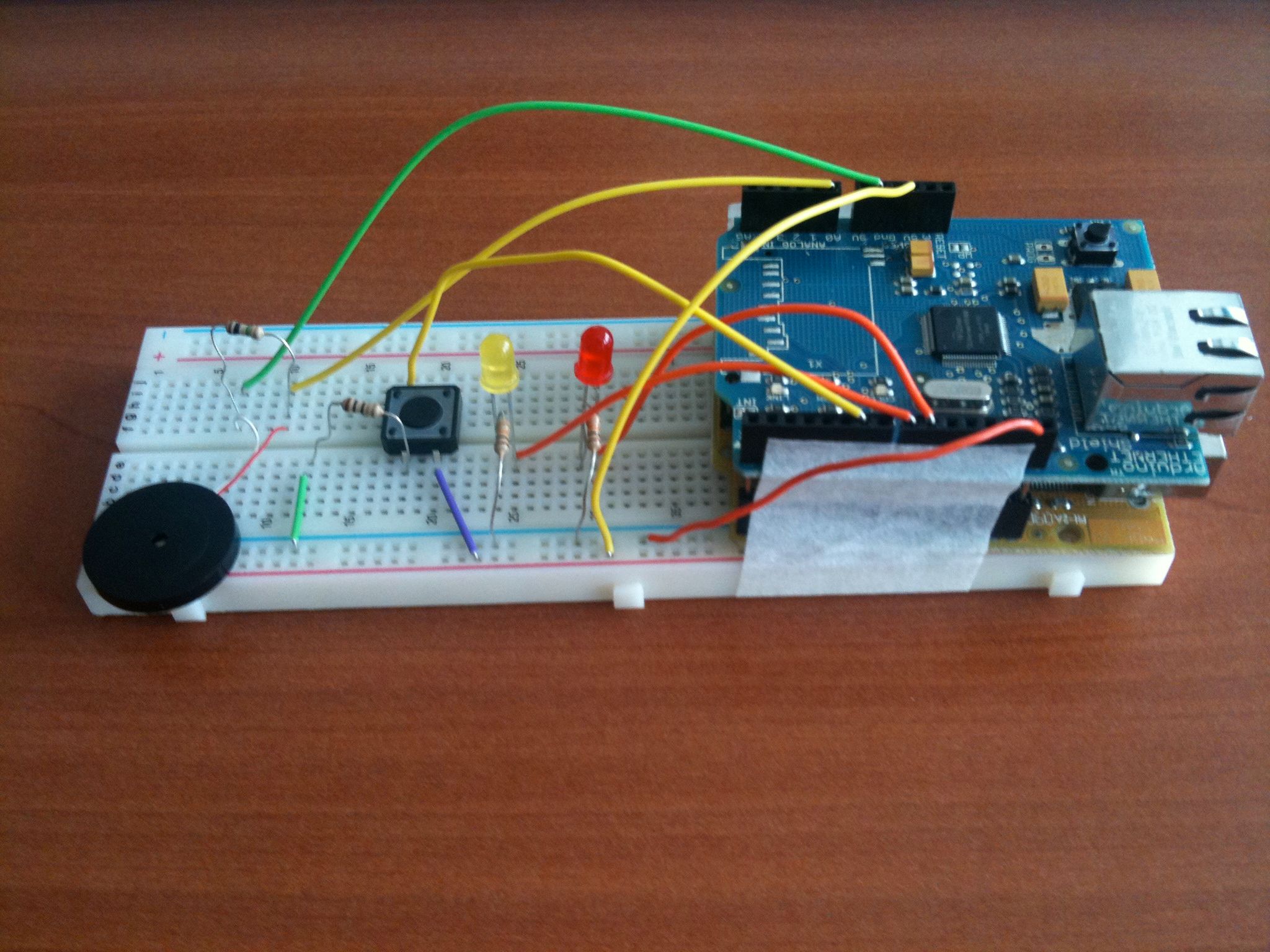

Step 1: Step 1 - Connect the Arduino to the Ethernet Shield
Step 2: Step 2 - Connect the LCD Display
This is a little harder, but again you can find detailed informations here. The link contains also some sample code you can use to check that the connection work. Please perform this action WITHOUT the Ethernet Shield.
Before proceeding to the next steps, you need to change a bit the schematics you find here. In fact, such schematics do not foresee the concurrent usage of the Ethernet Shield, which occupies pins no. 10-11-12-13 to communicate with Arduino. For this reasons, you should move the related connections (12 and 11) down to 9 (LCD RS pin) and 8 (LCD Enable pin).
