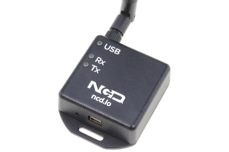

- National Control Devices 900HP-S3B Long Range Wireless Mesh Modem with USB Interface

Optionally, these sensors can be externally powered, making it a definitely best choice for wireless data tracking tool for the commercial equipment. Information can be transmitted to a PC, a raspberry pi, to Losant IoT cloud, Microsoft® azure® IoT, and an embedded machine all at the identical time. To send these wireless sensors' data to any system as we discussed above, we need a 900HP-S3B Wireless Modem.
Plug the 900HP-S3B USB Mesh Modem into your computer and then install the required drivers. The 900HP-S3B modem will mount as a COM port on your PC.
